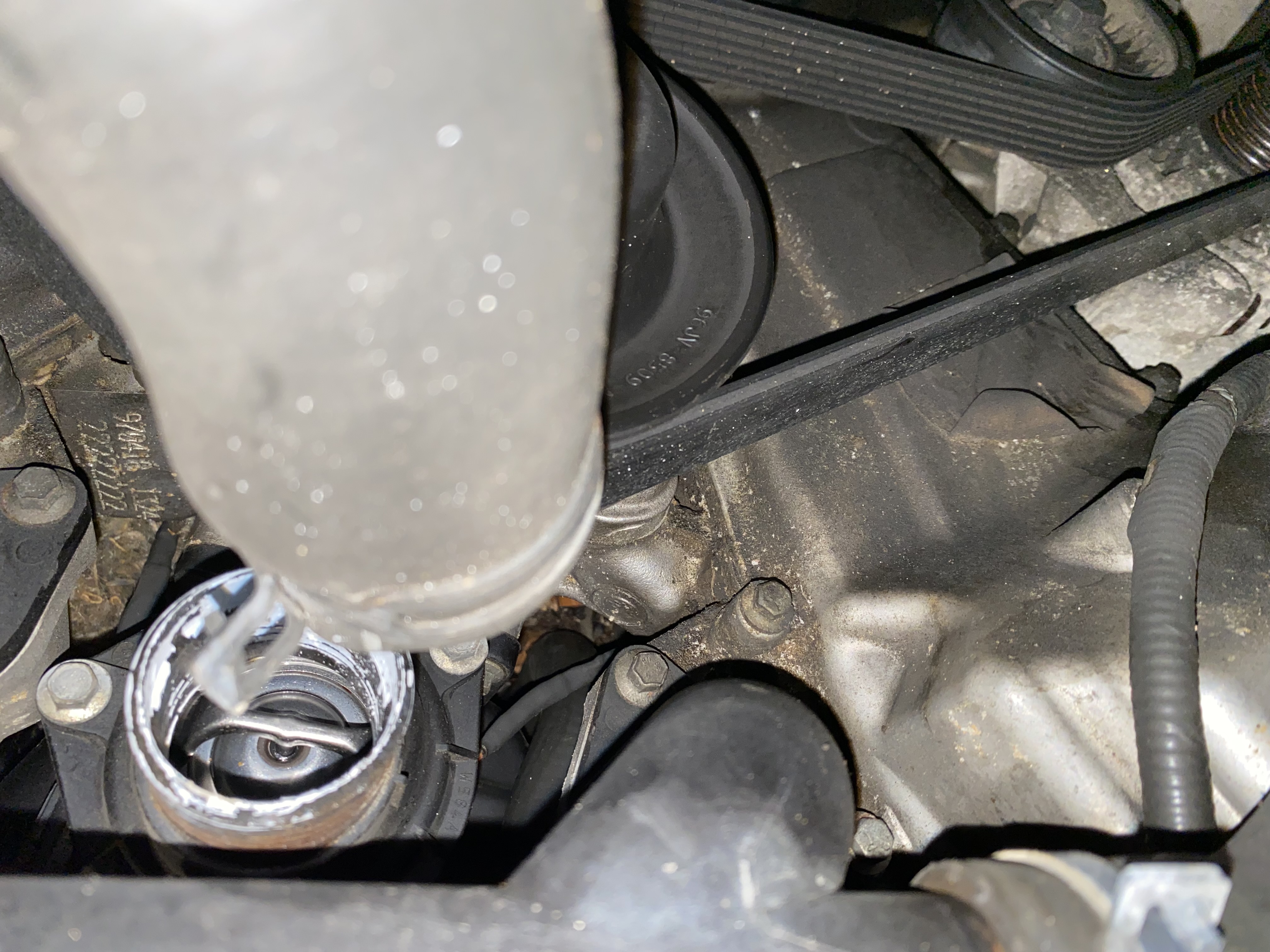

Hey everyone thanks for the advice. I took a look inside and it looks pretty obvious where the leak came from. I couldnt get the hose clamp back around the hose and the part its supposed to connect to, but I'm sure I can get it on if i use some hand tools. Do i still need to pressure test once I get it back on?? Today I'm gonna try what Pistnbroke said and just top off the coolant and see if it still leaks.

Thanks for the response, I posted some pictures of the hose that came loose, anything like that ever happen to you?

If the hose popped off a plastic fitting, don't expect it to stay in place. The plastic degrades over the years, so you should replace the thermostat tower, preferably with aluminum, and the outlet pipe.

I'd say take a hard look at the inside of that hose as well as the thermostat tower. That white residue suggests one of those cheap leak stopper products (or even mixed incompatible coolant). You might want to take advantage of this repair to perform a more comprehensive cleaning of the entire cooling system, even at the risk of re-discovering an existing leak.
Old Sep 8, 2021 | 12:51 PM
Jon89's Avatar
Joined: Jan 2009
Posts: 13,076
Likes: 4,724
From: Raleigh, NC
^^ I concur. That white residue could indeed indicate a problem. You do not want a mixed bag of coolant products circulating through your cooling system. If it gels up, it could wind up killing your engine at some point....

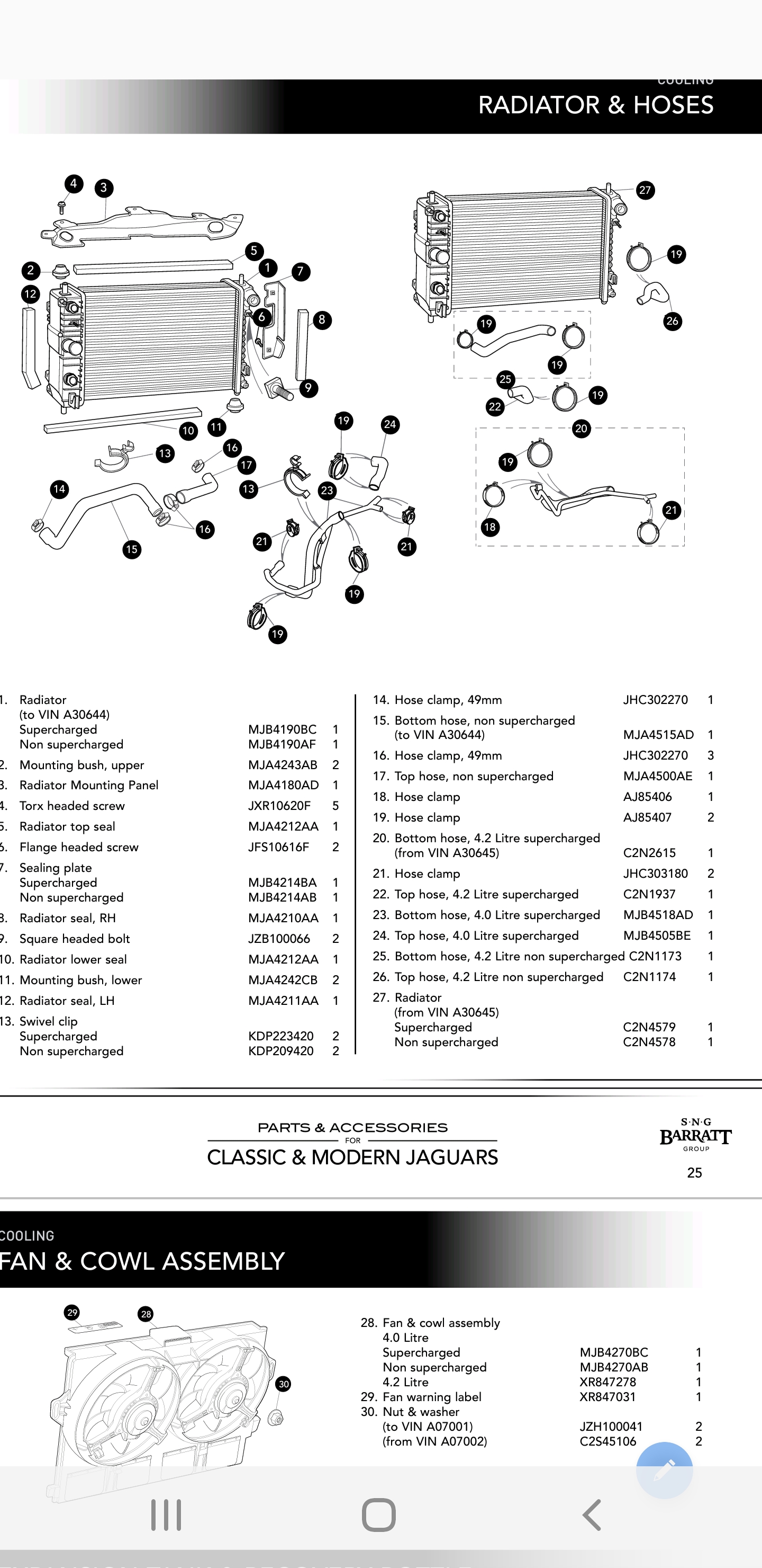

Piper goto SNG Barrett. Download parts catalog. This is 1 of 3 pages with cooling hoses.
John
