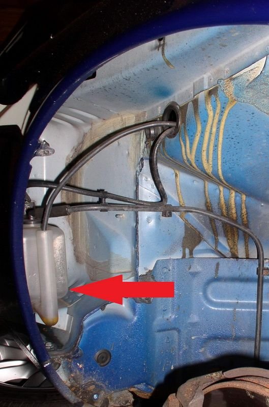

With a cold engine, this would be a typical level:

Thanks for this. Very good good guidance.
