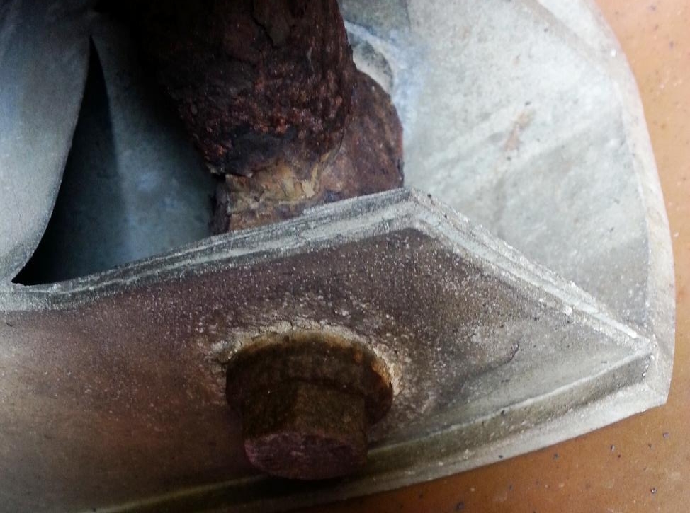

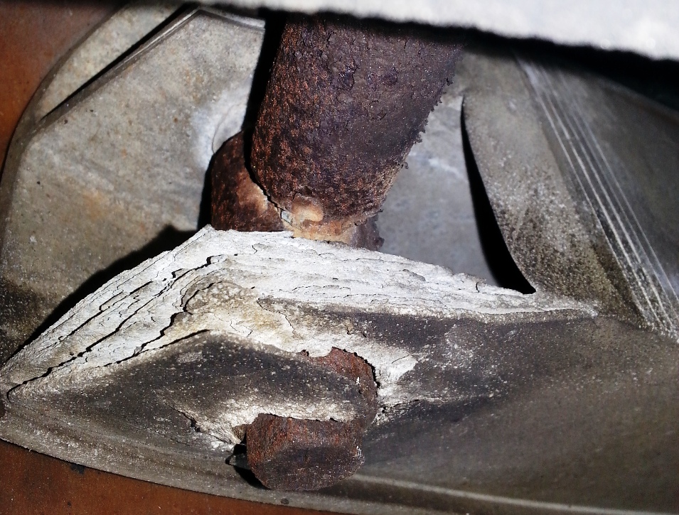

I'm preparing my car for a full respray in about 3 weeks...meaning I'm taking lots of things off the car. My 97 has the original style rear bumper cover, and my intention is to replace it with a later-style bumper cover that hangs a bit lower. Purchased the new item from our friend Tony (XKRacer) at Paragon Design UK.
Corrosion is not really a problem with my car. But today I see that I have bad corrosion at one of the bolt points for the rear bumper beam. It's as if the beam is de-laminating. Here's a look...fair warning...it's UGLY.
Removing or changing bumper covers involves removing this bolt. But I imagine if I do that, this area of the beam will disintegrate completely. And how the hell would I ever be able to torque a new bolt when re-installing?
The other side doesn't look nearly as bad, but there is evidence of early corrosion here, too.
This wouldn't appear to be a big deal...just a piece of steel, right? Well, the cheapest bumper beam I can find (through Gaudin) is nearly $ 800.
I need ideas, fellas. I'm sure our friends in the UK see this corrosion all the time...what are you blokes doing about this problem?
Attached Thumbnails Corrosion at the rear bumper beam...this could be expensive (Photos)-rearbumperbeamboltpassengerside_zpsdd93bc5c.jpg   Corrosion at the rear bumper beam...this could be expensive (Photos)-rearbumperbeamboltdriversside_zps7caa6c44.jpg   Corrosion at the rear bumper beam...this could be expensive (Photos)-491bfc06-b136-40be-a709-72469b7436fa_zpsaa878962.jpg

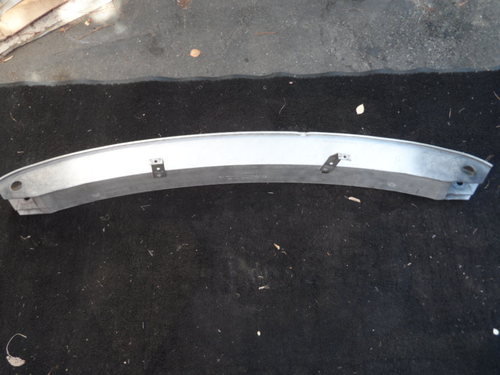

Ebay appears to be your friend today. BIN $75 + shipping
HH Jaguar XK8 Rear Bumper Reinforcement Bar 97 98 99 00 01 02 03 | eBay
Attached Thumbnails Corrosion at the rear bumper beam...this could be expensive (Photos)-%24-kgrhqjhjdkfibj6je-zbsjjjtkmy-%7E%7E60_12.jpg

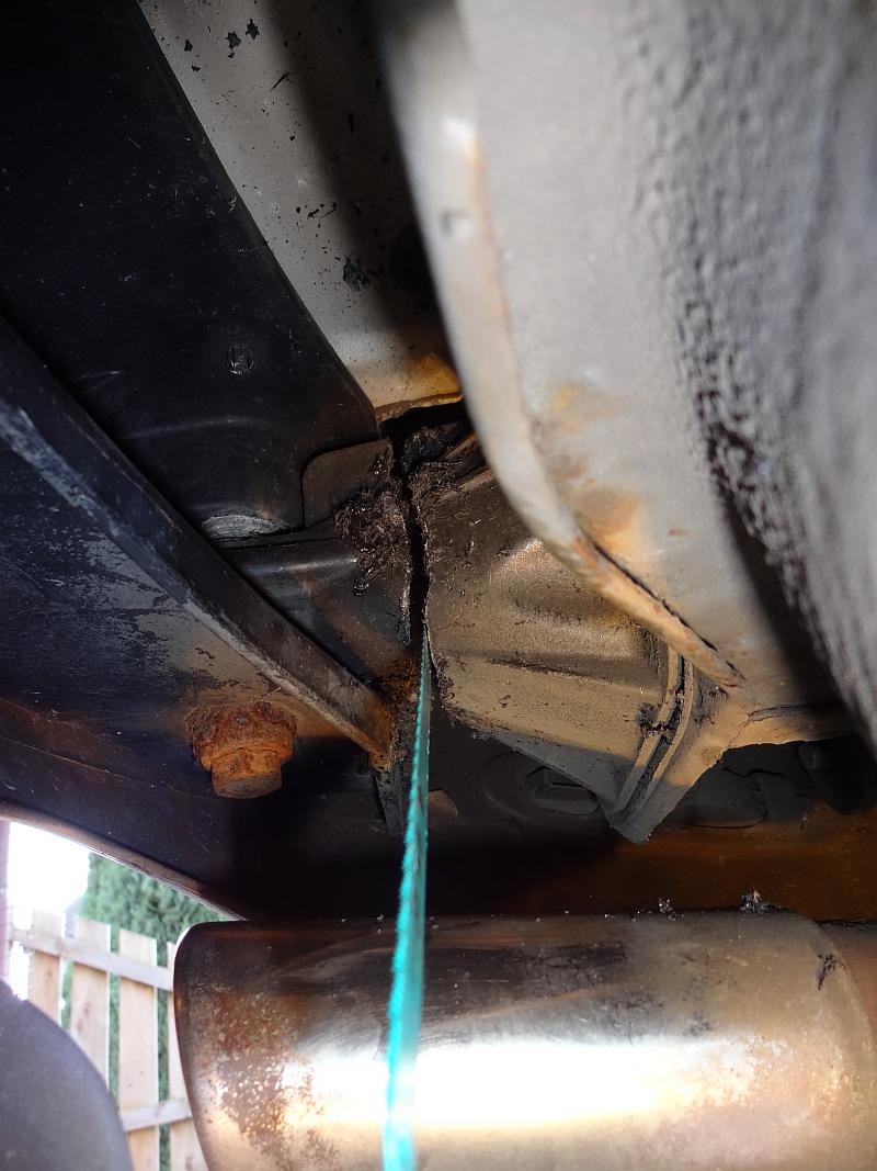

UK bumper with bolt stuck in the spinning brass fitting.
From below.
And above.
Attached Thumbnails Corrosion at the rear bumper beam...this could be expensive (Photos)-hack%2520saw.jpg   Corrosion at the rear bumper beam...this could be expensive (Photos)-brass%2520nut.jpg

Rothwell,
I owe you, buddy. Snagged this beam off E-bay, for about 1/10 of what Jaguar wants.
THANK YOU. Man I love this forum, and every one of you little punks that make this experience so much fun...and at times, so much less expensive.
