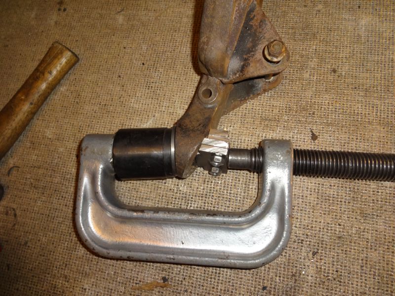

This can be a pig of a job, my first ball joint splitter broke trying to split it.
Once you do have it free and get the old one out of the control arm then you do need a special tool or jig to get the new one in.
There is no way this job could have been done in an hour on my car.
Remove the old one like this after cutting off the flange.
Getting the new one in is tricky as you need to make a tool.

When I said no special tools I must admit I took my press for granted, but I do not press the new ball joint in, I simply use a large deep reach socket over the top, hold the arm in a vice and tap it in with a hammer, I have done dozens like this with no probs at all.....
In all the years I have been doing this I have never fitted a standard bush, always been poly, which is very much easier than the OE of course the downside is you will have to do both sides
