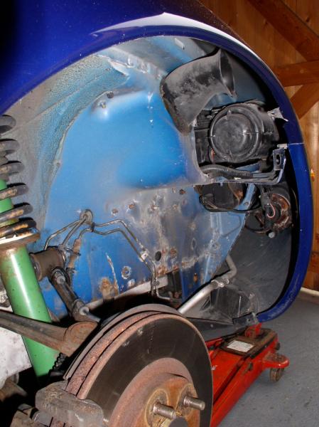

Can anyone help with this little blighter I found while working on the headlamps ?
You're looking forwards inside the wheel arch with the windscreen washer bottle on the left and the fog lamp on the right.
There's a fir tree fixing on it which isn't very clear.
Any ideas on the effete bit of aluminium tube in the background that rubs on the underside of the wiper fluid bottle then disappears towards the other side of the car?
Also - just behind the headlights is a long thin amber reflector/light mounted on the wing. Is it just a reflector or should it flash?
Edit - I think this is disabled on European models. I wonder if the dangly bit is supply to US cars?

Thanks guys - any ideas on the dangly connector??

Steve,
Can't make out the piece in your photo. I haven't got a photo of the LH but attached is the RH:
Is it the equivalent of the aluminium pipe emerging from behind the the front of the inner wing and disappearing down behind the brake disc in this photo?

Old Feb 20, 2012 | 01:56 AM
steveinfrance's Avatar
Posts: 6,278
Likes: 690
From: Limousin, France
Originally Posted by GGG
Steve,
Attachment 17019
Yes, it also goes through a rubber bush bolted to the chassis
Old Feb 20, 2012 | 02:50 AM
Likes: 17,004
Steve,
Looks to be the feed and return pipes to the Oil Cooler as I think pipes to the AC Condenser are smaller diameter.
Old Feb 20, 2012 | 05:30 AM
Posts: 6,278
Likes: 690
Steve,
Thanks, couldn't believe it was some sort of torque rod!
Old Feb 20, 2012 | 05:34 AM
Posts: 6,278
Likes: 690
Originally Posted by Alag
Steve The dangley bit? Is it a connector mine was taped up it twists on the bulb housing on the amber light
Al
It must be some sort of connector, it's got a geen and black wire going into it.
The 'reflector' on my car has a blind stub which looks like it would be a bulb housing in another life.
Presumably this is the connector for US models. I'll tape it out of the way.
Old Feb 20, 2012 | 05:47 AM
avos's Avatar
Joined: Apr 2008
Posts: 3,616
Likes: 1,070
From: Europe
It is indeed for amarican cars, at least I have seen it connected on 1 of them.
