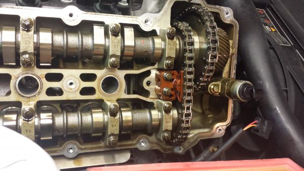

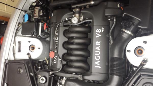

Before I started - still time to back out...
Here is the right bank old one:
And then the new one:

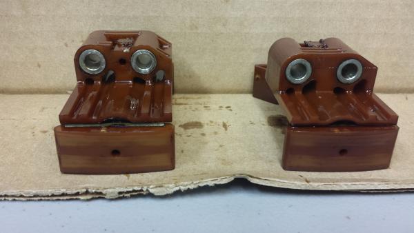

Here are pics of the old tensioners - you can see minor wear from the timing chain and some of the small cracks in the front, but all in all they seemed to still be in fairly good shape - BUT, better safe than sorry!
