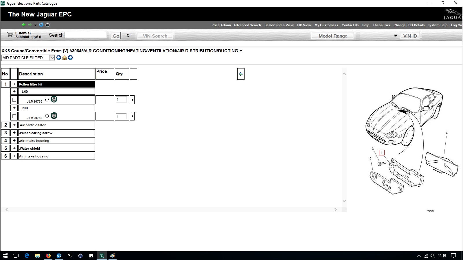

The air filter was available as an option, and most dealers declined to take it. The reason is that it takes a mechanic to reach it (the cowl area has to be removed, including the arms and wiper motor assembly). It is likely an after-thought. The parts to retrofit are available (a plastic template mostly) from Jaguar, and, guess what, the filter are typically available at a discount! I guess the fact that this option was hardly ever requested failed to be passed on to the filter manufacturers and they are sitting on a lot of inventory. As several other forum members, I have the parts on hand, but have not managed to pull the trigger and install them. Something about the insanity of spending 3 extra hours labor every year to replace the stupid filter, and the comfort of pollen-free ventilation in the spring. Oh well...
Details: retro-fitting-cabin-pollen-filter

Like fmertz I too have the filter but have never bothered to fit it.
The best time is when/if you have to replace a windscreen
part no is MJD6862AA...which I find is always good to post on threads like this for completeness

Apart from the difficulty in replacing the filter, the location was a bad choice. The few members who report having one fitted say it fills with rain water. The recommendation was to remove the filter and not replace it.

The Pollen Filter housing is a plastic box with a perforated lid:
The perforations in the filter housing lid let the air through ...... and the thing the designers forgot about - water.
The kit has a housing to fit over the air intake. Without the filter, the intake still has to be open to let air in.
I suspect the 'wind sound' you can hear is from one of the heater flaps not closing properly. I recall these have foam on them which dries out and breaks up. A slight gap could 'whistling'.
