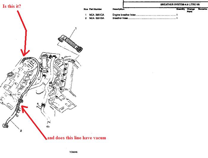

I have a 1997 XK8 and was looking for the Positive Crankcase Ventilation valve, or PCV valve. I see a hose on the air intake side but no pcv. On the other side (driver 's side) there is a small hose. I did not take it apart yet to see. I looked into the part list and did not see one. Attached is a page from the part list. I didn't find a PCV

Difficult to locate because there is not one. Just small vent orifice in the left side part load breather, open to the valve cover on the breather tube on the right. Are you chasing a problem or just looking around? The part load breather can and does get clogged up and needs cleaning.
