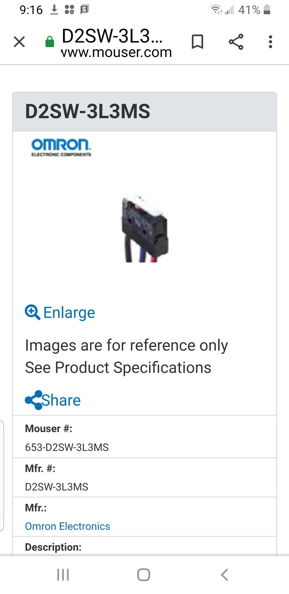

Here's the switch from Mouser electronics.
Do a quick search. Price is about $7.00

I've just done the exact micro switch replacement and it all went well EXCEPT that after a sound door thud I now have the Door Open warning light on, puddle light etc. The Omron switch you get needs to be bent to match the same height that the one comes out. I did that but I don't think I did it enough. It looked similar but sadly I should have added a smidgeon more for good measure. See the many great articles, google - xkr door ajar micro switch
With a torch you can see the end of the switch in the door lock if you manually close the latch. If I then use a small screw driver and push the switch lever end a tad it opens the switch and is where it should be. I went to the good side to validate this too. Once you have closed the latch, open the door pull and use a screw driver to pull the latch back open again.
