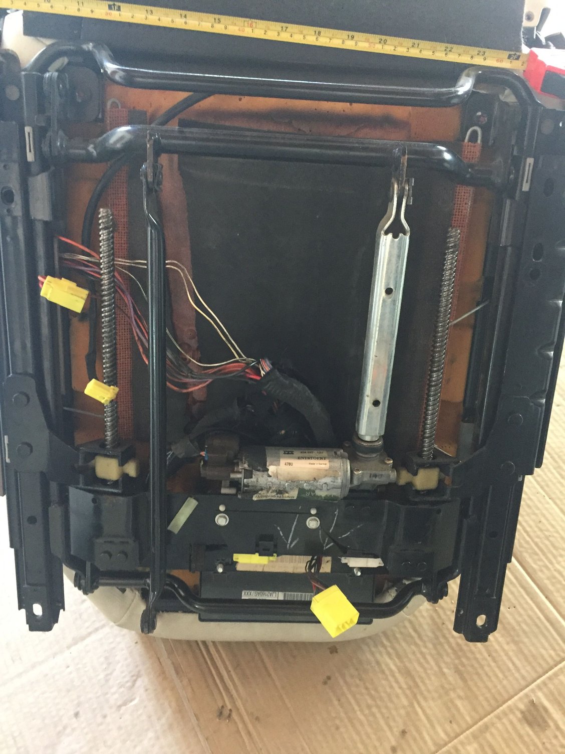

Default Bad position to be in. Can you check connectors under the seat?
Bad, bad position to be in. Before you start cutting the bolts from under neath, can you stick a mirror under neath the seat to check the connectors. If they have been bumped loose, can you reach to re connect.
pic of bottom of my seat in my 99 XK8 below.

The probability that the seat control module under the front of your seat was crushed to some degree like they all get and stop working. The best thing to do is get a 10mm socket with a small ratchet and unbolt that module, disconnect it and swap It with the passenger side seat module so you can at least move your drivers seat.
