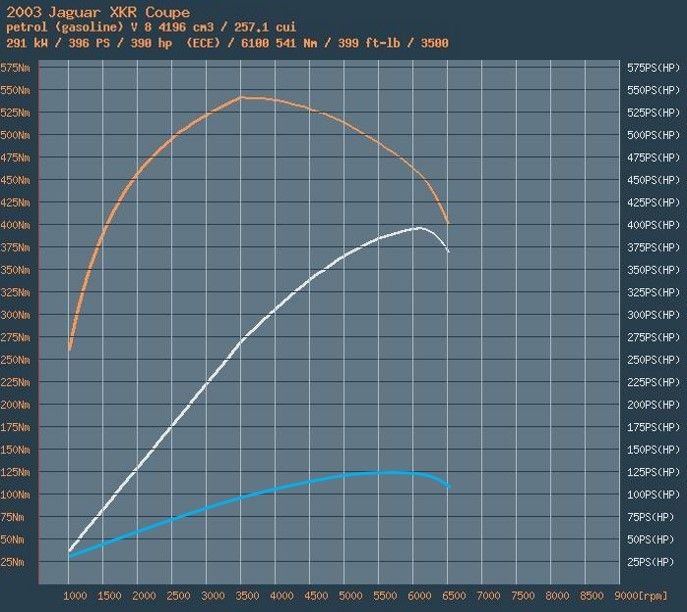

The low performance is due to the relatively low Compression Ratio of 9:1 in the 4.0 XKR. The engine is designed to expect a minimum quantity of air volume from the Supercharger and this minimum requirement is simply above that achieved with normal aspiration.
Roughly plotting your measurement (Blue line) on my own power chart (standard 4,2 XKR) it appears peak power without Supercharger is about 125 HP !
Interesting. BUT the low power is mostly because it now breaths through the bypass valve and are choked from air. I did not measure how big that butterfly valve is, but about 25 mm (1 inch) maybe?
Agree that is very restricted and a major factor.
