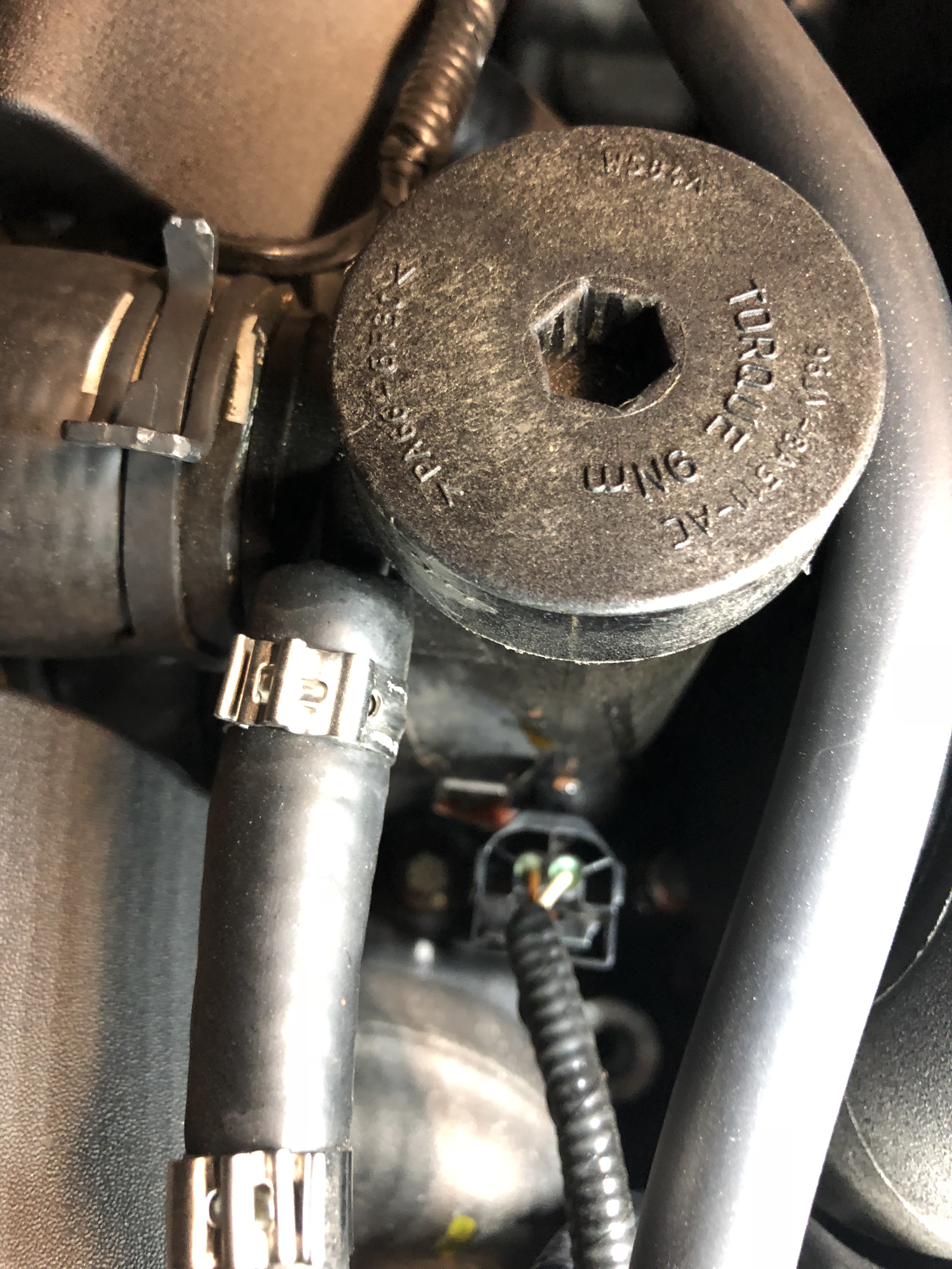

My wife has an 2002 XK8, I when I returned home from a trip. She told me that the electric fans came on after a short drive in 60 degree (F) weather. I looked to see that the coolant was a bit low in the expansion tank. After topping off the coolant, I then noticed some coolant at the base of where the coolant enters the block (see the attached photos). It is a vertical piece that has a round cap with a HEX fitting in the top. In the case of this particular non-supercharged 4.0 V-8, what would be the symptoms if the thermostat was not opening?

After reviewing the photos on the post, I wanted to add that the coolant is sitting at the base of the black plastic piece, just below where the wiring is is plugged in. It is difficult to see the small pool of coolant, but you can see what appears to be dried coolant on the plastic piece.

That's the thermostat housing, a common failure. Buy an aluminum one from one of the sponsors and locate the diy in the sticky. The overheating was probably due to the thermostat sticking, so make sure a new one is included.
Most of us would suggest replacing the black plastic crossover pipe, upper and lower radiator hoses and the short hose between the pipe and the housing. Some would also say include the water pump and serpentine belt. Where does one stop?

As RJ237 indicated the plastic thermostat housing is a often source of coolant leaks. He didn't mention that you were going to learn a few new terms like 'bent wrench'. The rear bolts at the base of the housing are effectively inaccessible without a special tool. Search the forum for more than enough information to make this a relatively easy job.
I strongly urge you to replace the plastic housing with the aluminum version as it is less expensive and an one time effort. Paint the bright aluminum black to match the all black engine or it will end up a shiny beacon until it corrodes into an unattractive dark grey color.
All your hoses are now 15 years old and you certainly wouldn't drive on 15 year old tires. Not a bad job except for the bottom left clamp.

Echoing what's already been said, this might be a good opportunity to address all the usual suspects 'while you're in there' and include the valley hoses.
The crossover pipe is made of the same plastic as the thermo tower and ages just as badly. Sadly nobody as yet has copied it in aluminium.
Nothing to be scared of here, but note that the lower radiator hose has a slightly larger bore on the radiator end (where the awkward clip is). It's possible to get this on upside down
Forum sponsor SNG Barratt can oblige with the ali tower, and most probably everything else.
