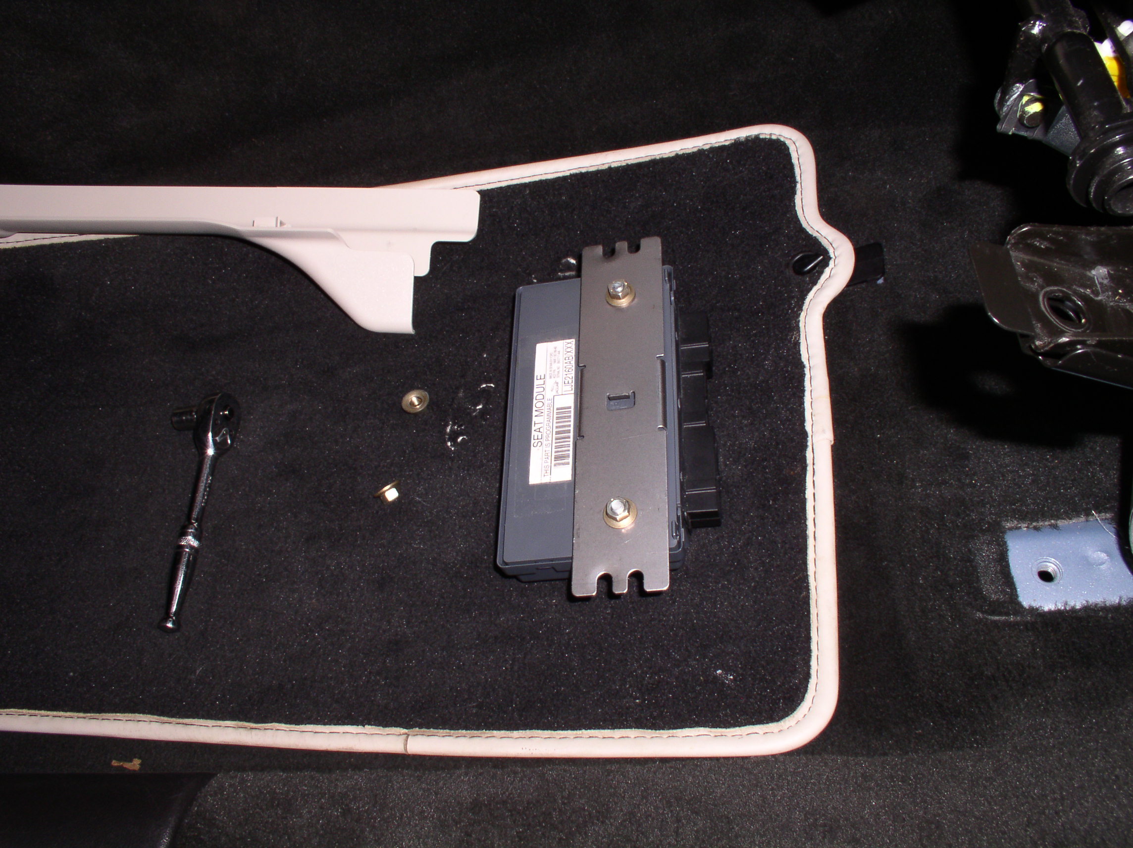

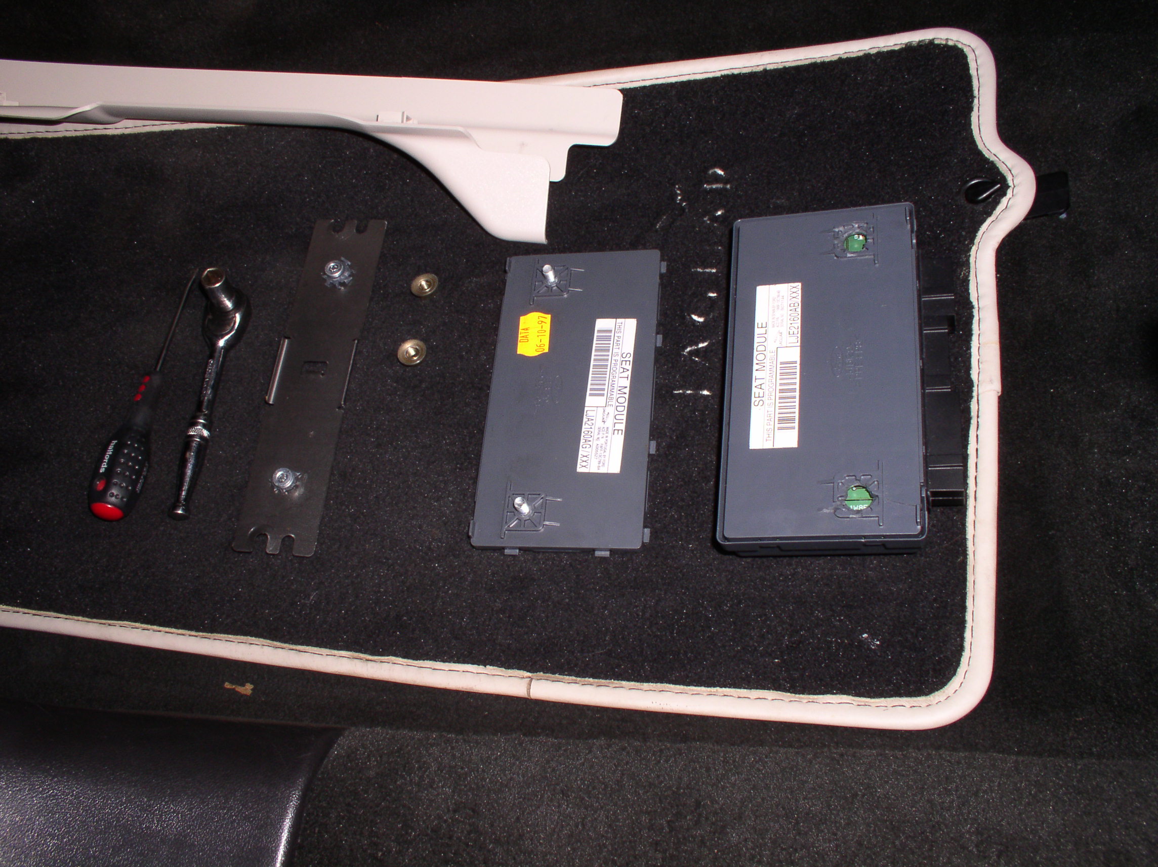

This is a regular issue.
If your Seat Module is sticking out of the front of the seat, it's almost certainly because the fixing studs have been ripped out of the lid. Compare the Seat Module on the right (fixing studs ripped out) with the lid to the left of it (studs in place) in this pic:
The Seat Module is bolted to a bracket and the bracket then bolts to the seat base. This pic shows the bracket attached to the Seat Module after I'd replaced the damaged lid:
Electrical connector in boot (trunk)-13-passenger-seat-module-bracket-fitted.jpg
Good news is replacement lids are available at low cost from Jaguar Dealers.
