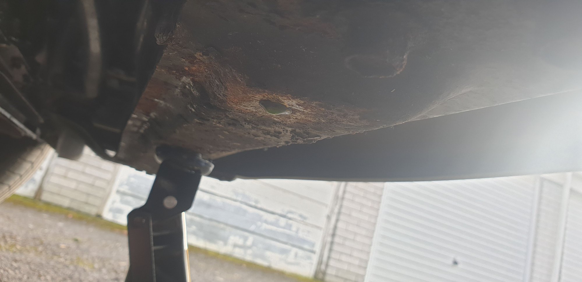

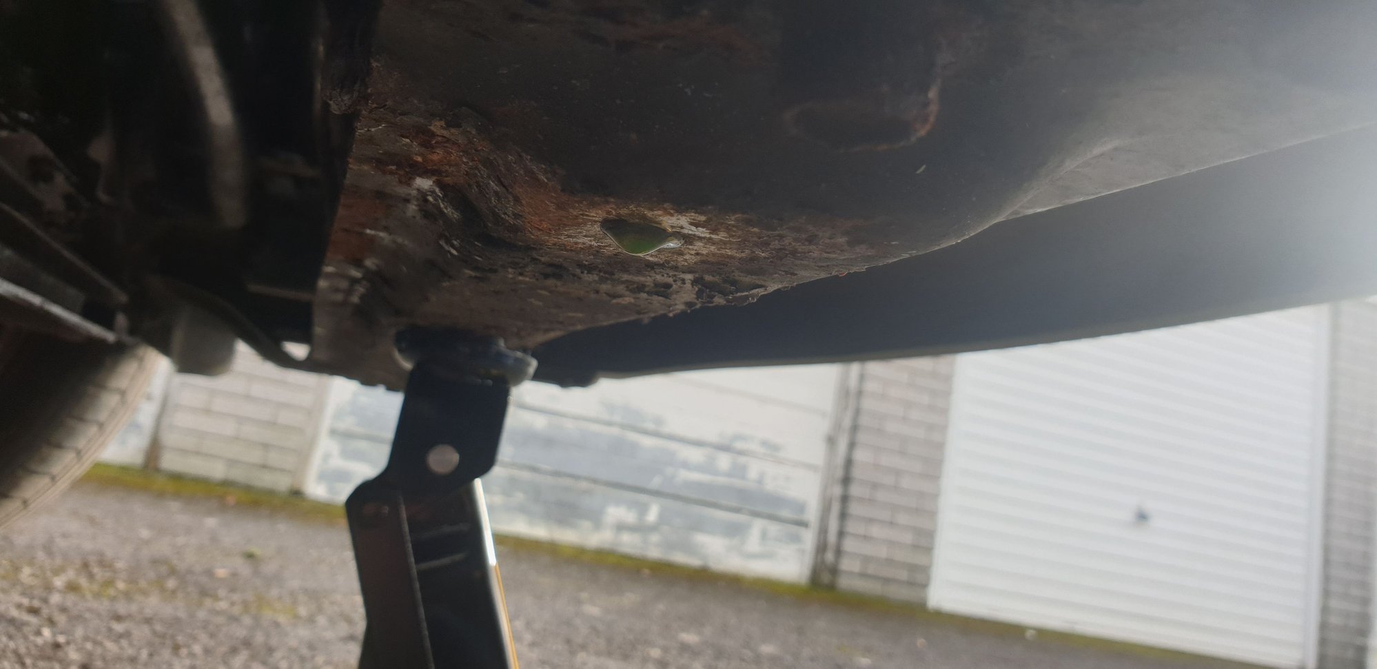

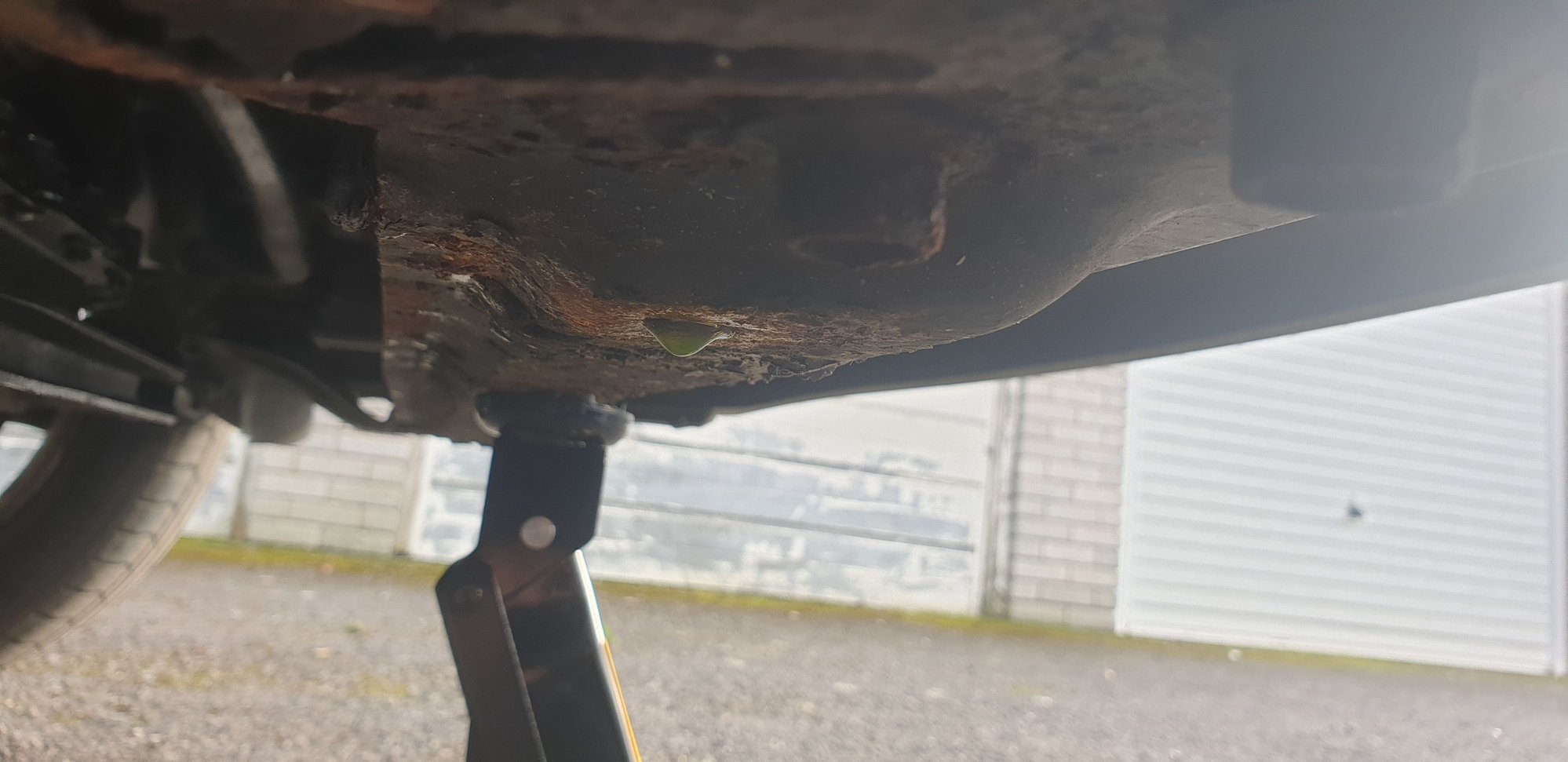

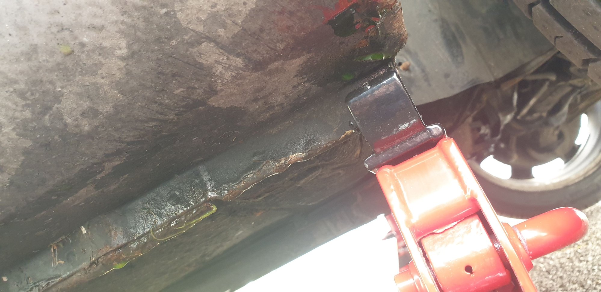

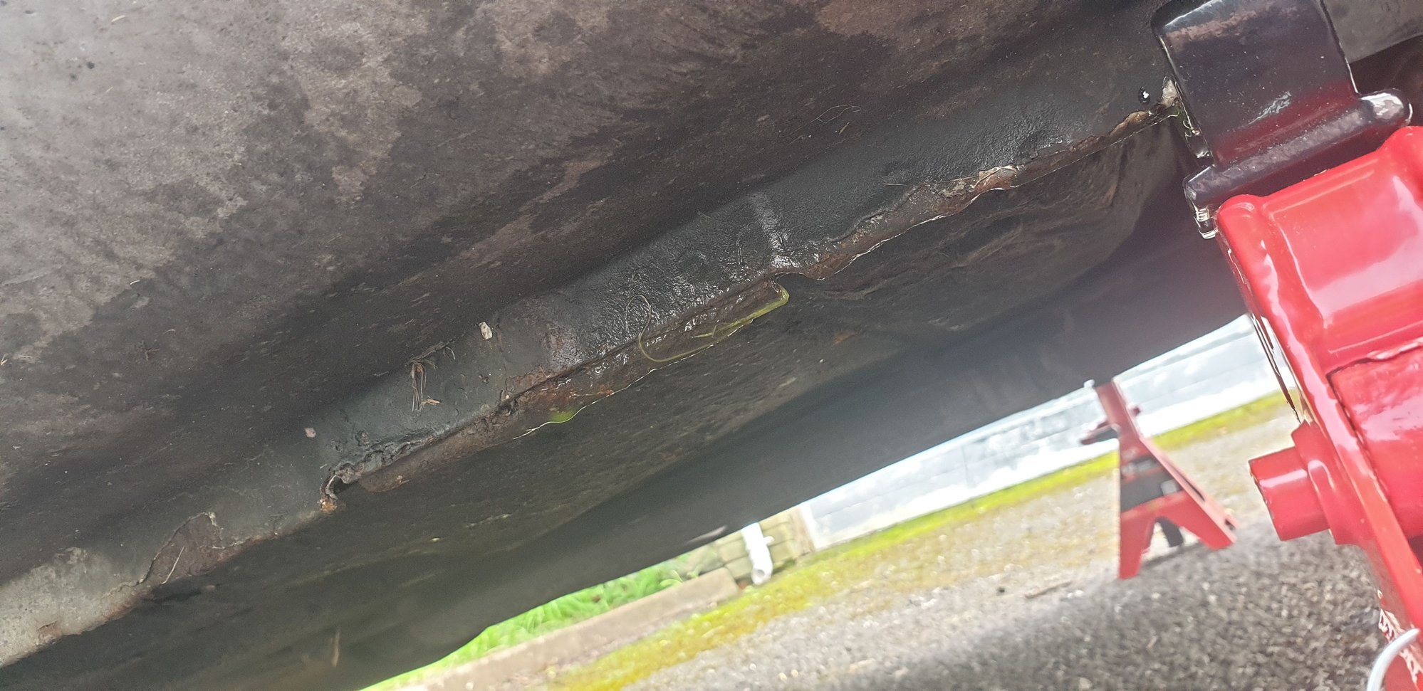

Hi all, I'm new to the forum and about 8 months ago I bought an XK8 year 2000 (with the AJ27 engine for what it's worth).
It has a coolant leak in two places.
The first place is the OSF sill just behind the wheel arch. I expect this is the atmospheric overflow tank that exists behind there so I'm not worrying about how to fix the source of that leak.
The second place is right below the front cross member that runs below the radiator. I've taken the undertray off and jacked it up and can see it leaking. I've checked all the hoses and have UV dye in the coolant and can't spot anything leaking even whilst the engine is hot. I've therefore come to the conclusion that there must be a hole in the radiator or a plug/rubber bung that's deteriorated.
I've had it pressure tested twice by Swallows Jaguar. Both times it's come back clean.
If anyone has any thoughts please let me know.
Thanks all.
This is the front cross member dripping coolant
This is the OSF sill. (The axle stand wouldnt push back any further and my trolley jack won't go any higher in case youre wondering)

Hello,
that's pretty wet.
There are 2 weak points: The expansion tank develops cracks over time. You have to look carefully for traces, even from below. It's best to remove it quickly.
The thermostat housing will also break at some point. There is now a replica made of aluminum.
Good luck and keep us updated.
Best wishes, Willi

Originally Posted by Jag_Willi
Hello,
that's pretty wet.
Best wishes, Willi
Hi Willi,
Expansion tank was replaced very recently. The thermostat was replaced too with aluminium upgrade.
