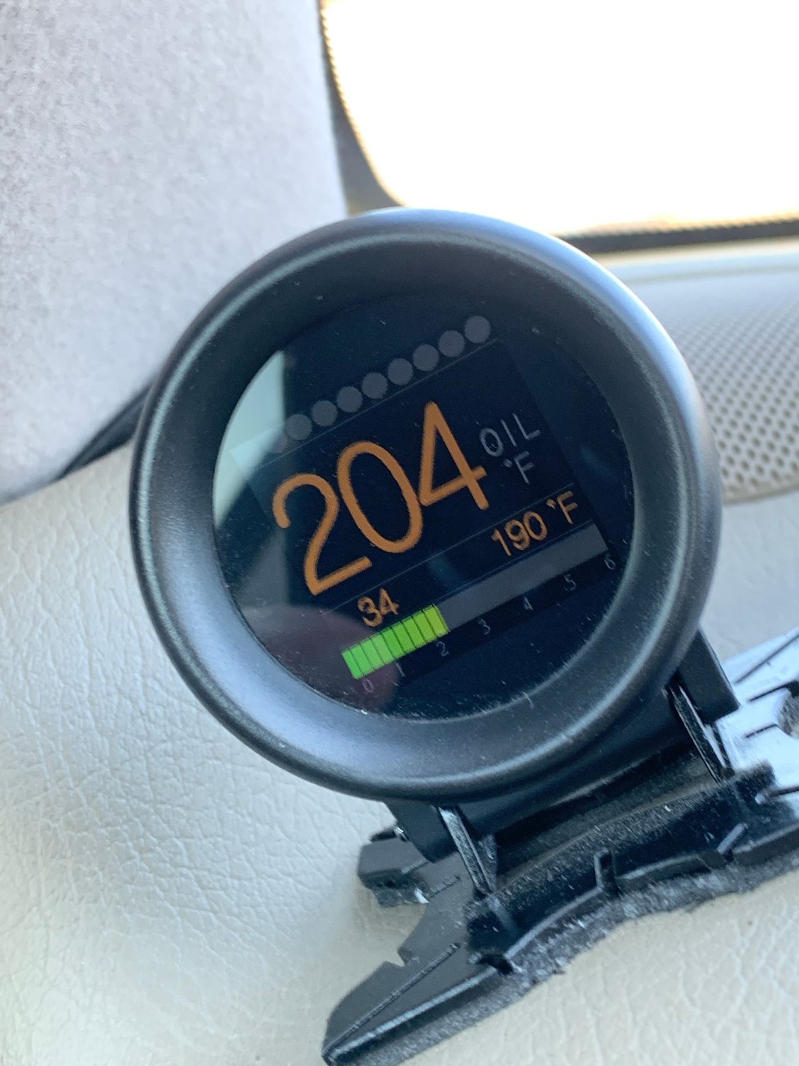

This is what I use to monitor a variety of functions.(fuel trims, oil and coolant temperatures, battery voltage, etc etc it plugs into the OBD-II port, and can read / clear basic codes.
It is indispensable for peace of mind , and catching issues before they evolve into an expensive problem.

I also have installed the same real gauge items, and yes the temp gauge reads 2 hash marks above the center mark on the dash instrument....the mid mark represents about 185 degrees F and each line represents 15 degrees, then the engine is reading about 205 at running temp. At least this is what I understand, and is about the correct operating temp for our engs.
