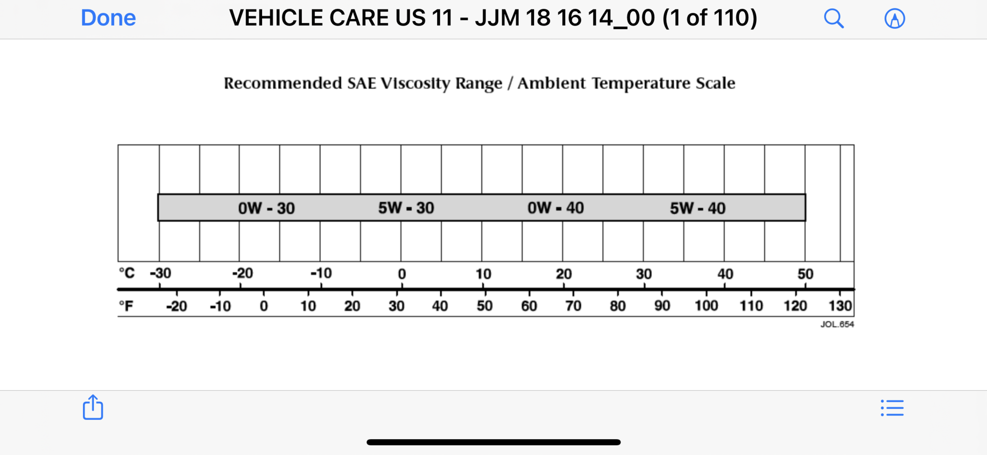

Houston gets hot enough to use 0w-40 year round, or 5w-40 in the warmer months, as per manual recommendations for climate.
yes, when the piston moves faster, you will get more rapid piston slap. Just let the car warm up before revving the engine. That is the prudent way to go.
knocking from rod bearings typically does not go away when the motor is warm. Piston slap does.
Z
