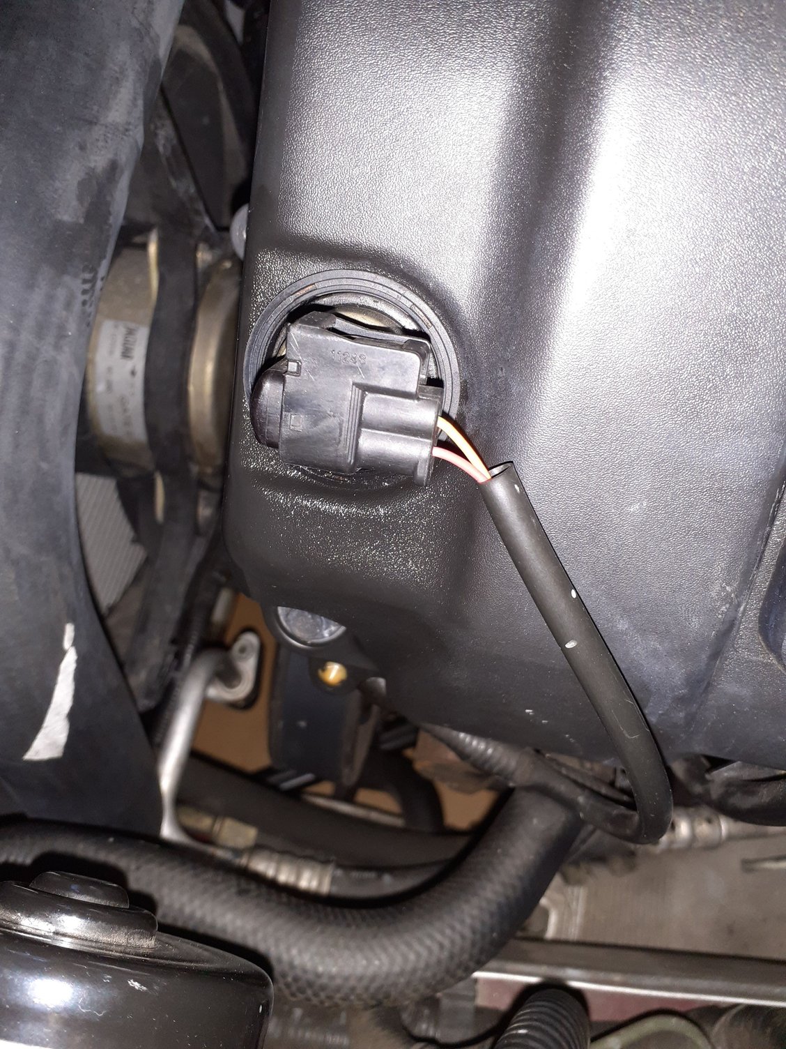

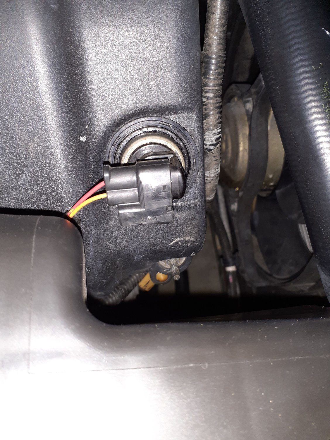

OK, I admit, I am no mechanic. 99XK8. I had the timing chain parts and water pump replaced by a local shop. Since getting the car back, I have noticed a slight leak under this part. What is the part/function? Is this something to be concerned about? Is it easily replaced (possible O-ring needed)? Before replacements, the engine was completely dry, no leaks. I am trying to learn and start repairing items as I am finding in the first two months of ownership that would be a valuable skill. Your help appreciated. After downloading 187 page manual, this part was NOT shown...
Driver's side LH - US leaking
Passenger side - Dry

Those are the VVT solenoid O-ring seals. They sit in the engine bay and bake, getting hard and brittle in the process. They eventually start seeping oil and when they do that, they can also leak air and cause OBDII codes to be thrown. In the nearly 11 years we have owned my wife's 2006 XK8, I have replaced them at least four times. Rockauto sells them for a relatively decent price - they should be replaced in pairs so you can keep up with the replacement schedule. Jaguar part no. AJ82856. I last replaced them in January 2022 and paid about $17 for the pair at rockauto.com....
After you remove your old ones by carefully prying them out with a small screwdriver, be sure to thoroughly clean around the area with a rag to ensure a tight seal when you press your new ones into place. You want that entire area clean enough to eat off of before you press your new ones into place. I use the tip of a wooden dowel as a pressing tool so I do not damage the plastic face of the seal as I press relatively hard down on it all the way around it. No other tools needed. Expect them to last two to three years depending upon how often you drive the car. Engine bay heat bakes them and causes them to eventually start seeping, so take a look at them whenever you open your hood....

Thanks. I figured it was some level of O-ring wearing out. In this case the whole unit needs to be replaced it appears. According to your description, I should be able to handle this job.
Anyone have any other warnings before I jump into?

Only the two O-rings need to be replaced - the solenoids and electrical harnesses connecting to them are fine. Just be careful disconnecting the two plastic electrical connectors. They can get very brittle as well....

@XK8WGM, to remove the wiring harness connectors to the VVT solenoids, GENTLY squeeze the connectors whilst pulling back to disconnect the plugs from the solenoids.

Thanks for the help. It was a quick 10 minute job. Most of that just cleaning up the surrounding area. Hope it holds.
