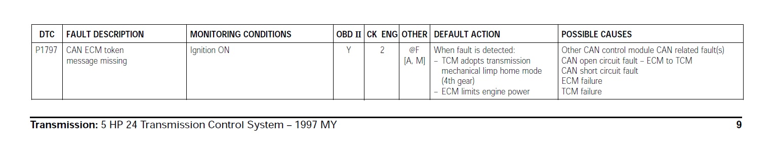

Here's the relevant extract from the Jaguar DTC (Diagnostic Trouble Code) list for P1797:
See 'Possible Causes' in the right hand column.
Now you have the code, the first step is to clear it and see if it returns. Sometimes an error code is set by a transient out-of-range signal, especially on vehicles that have been unused for lengthy periods. If you're not so fortunate as this and the code sets again then it points to a network (CAN) fault or a module fault. A TCM (Transmission Control Module) is a more likely suspect than the ECM (Engine Control Module).
