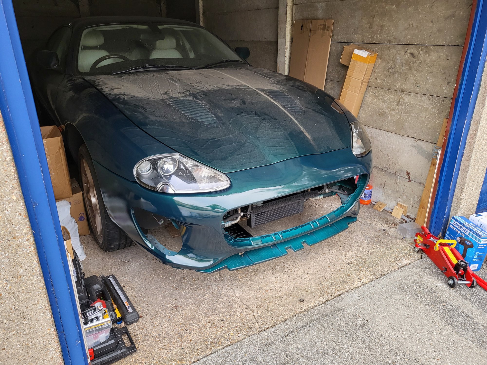

I had posted a few updates in the "What did you work on today" thread but it was requested that I start a dedicated thread for this.
When I have completely finished I will do a full walk through with pics but for now this is an update of how I have just left the car.
Bumper all painted but still needs all the griles and trims attaching.
In my infinite wisdom I enlarged the side grills in order to get a more project 7 look but now realise I have to make the mesh inserts myself!

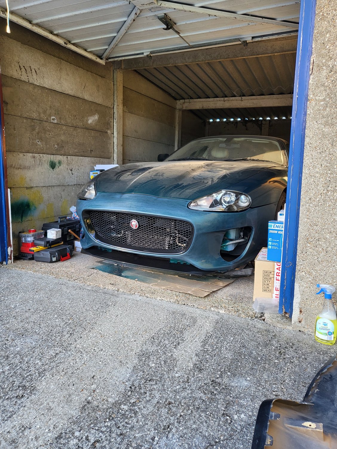

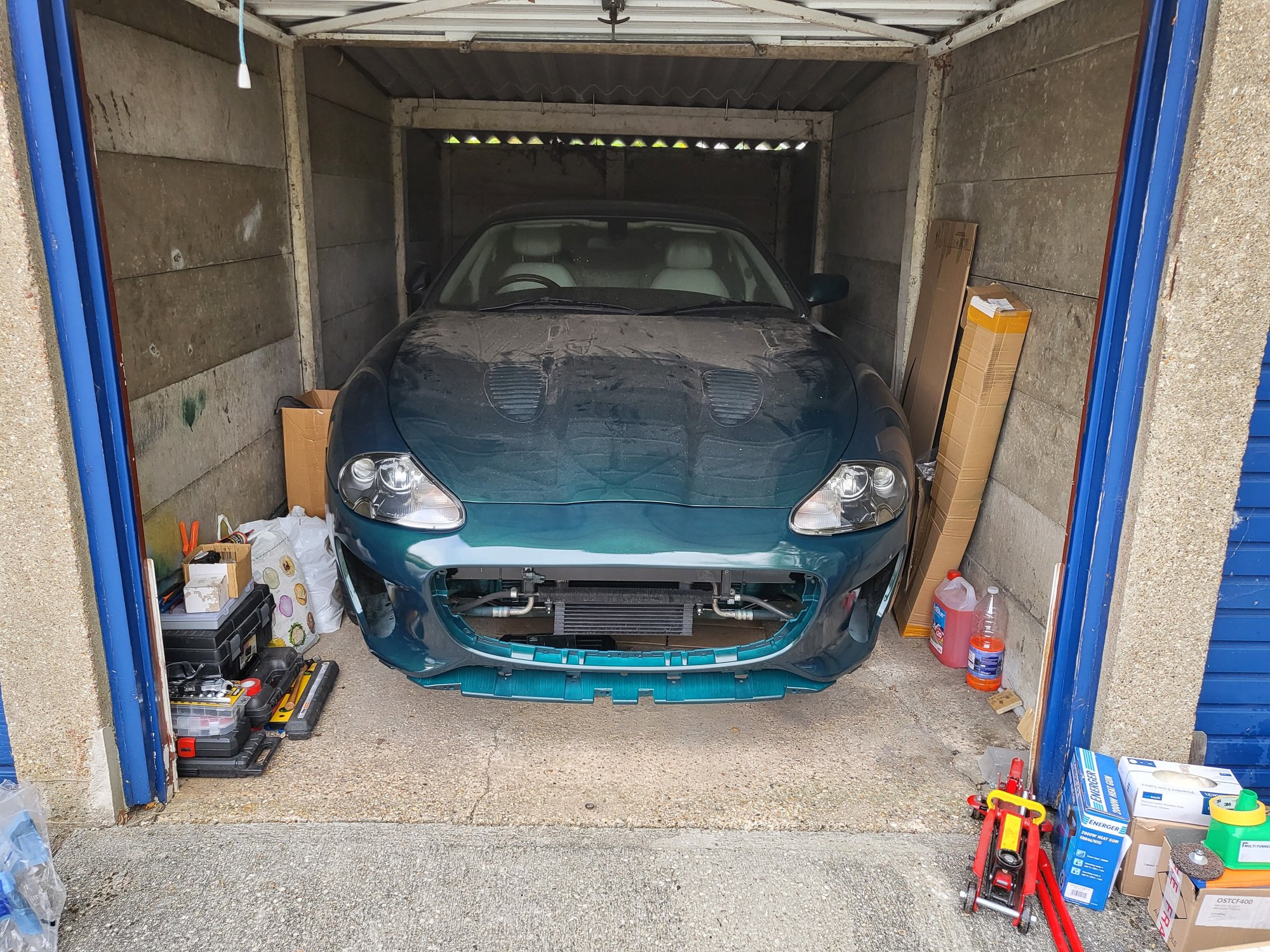

I am hoping it will have some affect. I had intended to leave the crash bar off which would have definitely improved air flow as you can see when I test fitted without it.
But then I thought should be a bit more sensible so made my own crash bar which is a bit more restrictive but not as much as the original.
I am planning to add some brake ducts as they will conveniently fill the gap left between the new bumper and the original arch liners. The f type bumper being straighter at the edges means there is a gap where the original arch liners curve to the shape of the xk8 bumper.
I am also going to run the intake pipe down behind the headlinght to sit inside the left hand (from the front) vent.

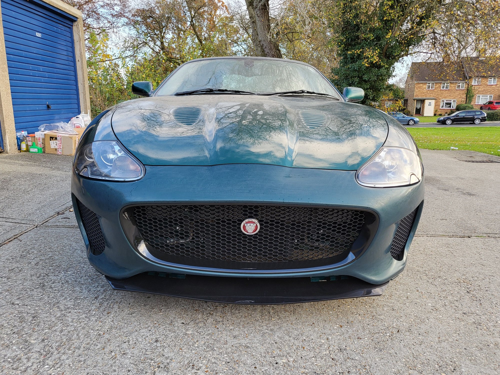

A little update... I made a Project 7 type grill from a standard surround which I modified to remove the bar and some ABS honeycomb mesh.
Also wet sanded with some 2000 so I can buff it on the car as I think it will be easier that way.
Now I need to think about what I do with the side grills.

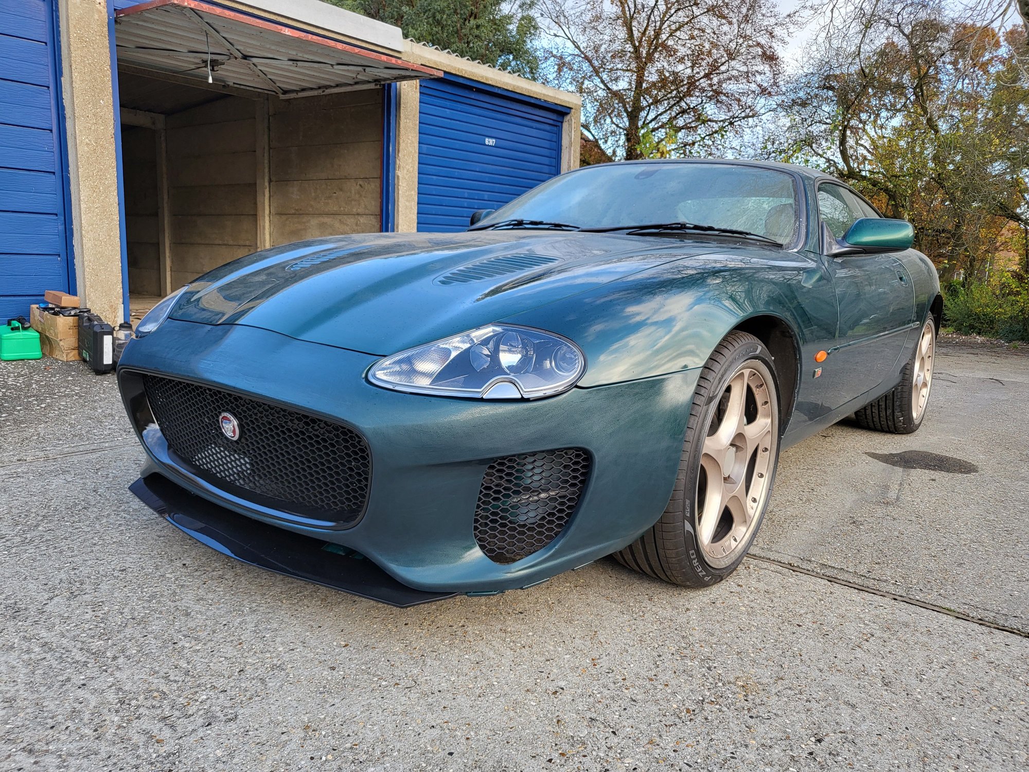

It has been a pretty slow winter in terms of work on my XKR. My tiny garage makes working inside impossible and I have been focusing on a risk hole in the floor when I have had time to work on it.
Bumper is pretty much done now, still needs buffing after the wet sanding but weather has not allowed this yet.
I am also working on some modified XF side skirts which should compliment the front and help the lines flow through from the front.
