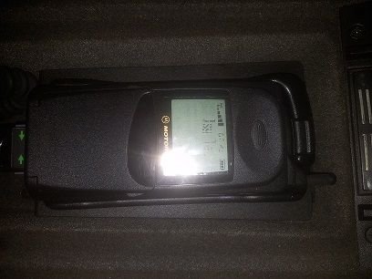

Phone calls are taken care of by this piece of 90s bleeding-edge OE techno:
