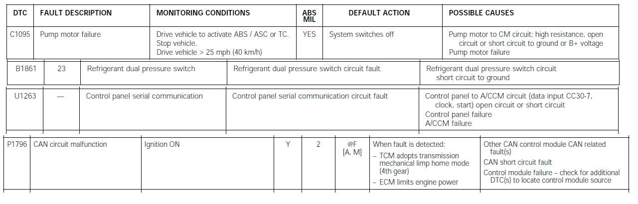

I'm pushed for time this afternoon but here's the possible causes for most of your list:
P1796 is the reason the vehicle keeps going into "limp home" mode.
