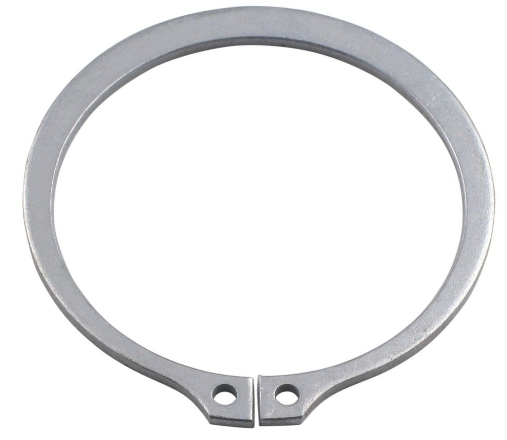

  • The snap rings on my shocks were one bad pothole away from slipping off. They were likely to fail at any given minute, and as a consequence the springs would have slipped right down the shock onto the control arms. I was able to obtain sturdier, slightly thicker, tighter fitting snap rings at a manual transmission service shop. They gave them to me for the low low price of free. I know some would have defaulted to forking out over $800 for a pair of new shocks at that point. So as a heads up, snap rings can be found at Manual Transmission service centers if you ever need one.

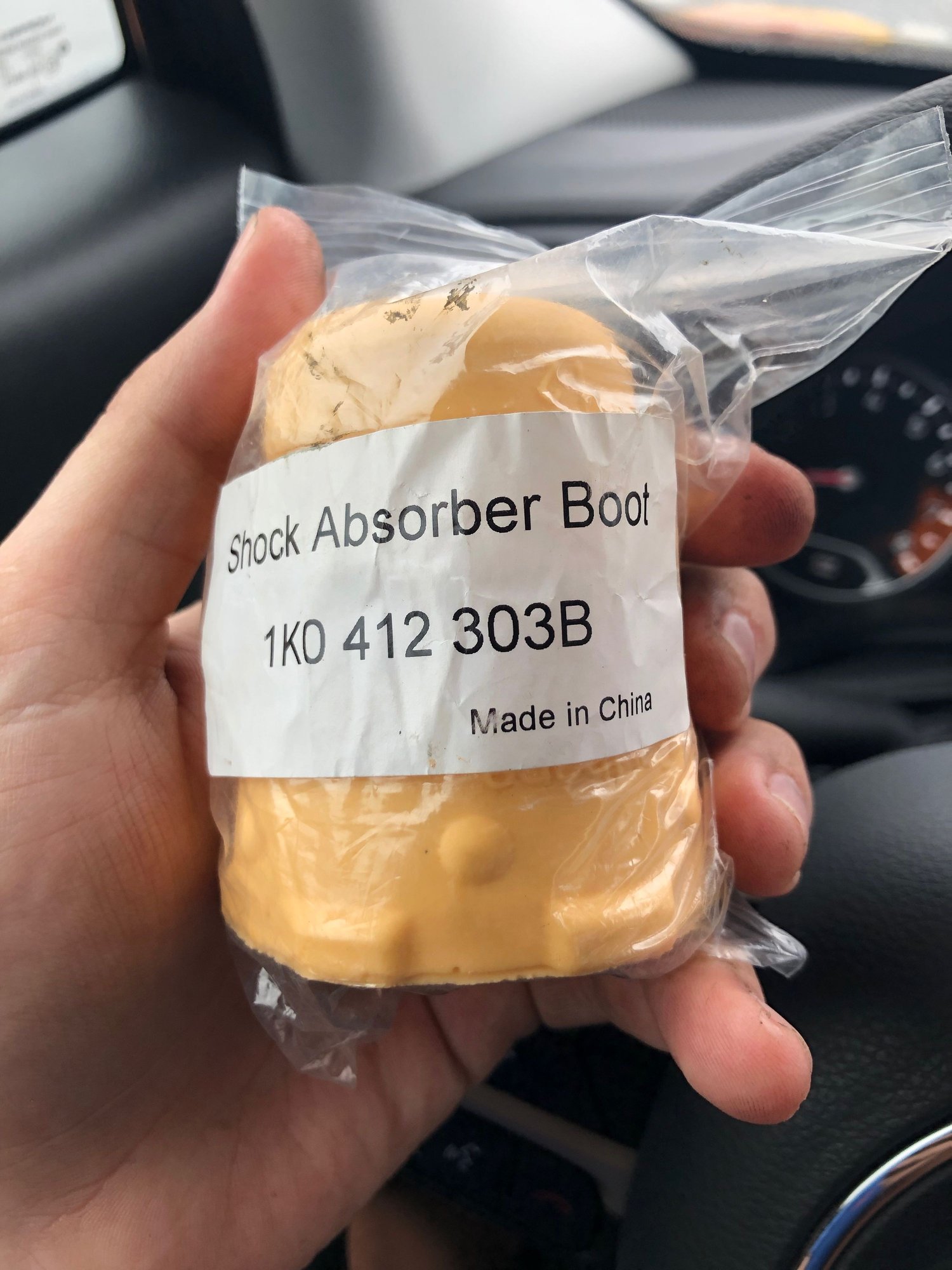

  • Because this is a rare car, most auto parts stores don't routinely stock parts for the XK8/R. So, if you ever find yourself needing a Bump Stop without having anticipated it, you would either have to source it online, or the parts shop would have to order it through their distributors. But, the good news is that they can be obtained much faster. Part #: 1K0412303B for the Volkswagen Jetta (05-'15), Passat, Tiguan, Rabbit, R32, Golf, and EOS, is an exact fit, and is readily available at European autoparts stores. Cost is: $9.99 each. I can confirm that this bump stop was a perfect fit when I installed it. Unfortunately, it seems to be the same exact material, which leads me to believe it is in fact the same part.

John, in the following picture of the front shocks I circled the snap ring. It's function is to hold the spring packer in place and set the resting position of the spring and how far it can compress. On my shocks, that ring was nearly destroyed, I replaced it with a sturdier snap ring, which I have also attached to this post.
There are different kinds of snap rings, but I chose this one since it was the sturdiest one I could find that was also easier to manipulate onto the shock absorber. Now you may ask why this one is easier to manipulate? It has those two little holes to which you can fit a special plier to open them up enough to slip onto the shocks. Other types of snap rings may be more symmetrical, but they don't have this feature. Now, when choosing the snap ring, make sure that you choose one that has a slightly smaller diameter;1 or 1.5 mm less than the shock absorber itself. This way you ensure you have the tightest fit possible. Sadly I didn't measure anything since it all happened spur of the moment. The only place where I could find snap rings big enough was at the manual transmission service centers.
Fitting the snap ring is very easy. Remove the old one, (in my case they fell out), and then use your pliers to expand the new snap ring enough to slip it onto the shock. On the shock, there is a groove where the old snap ring was located. Once you slip the ring onto that groove it will not budge. Then I slipped the spring packer and slammed it hard onto the snap ring to make sure it had actually seated properly. If it had not been seated properly, the spring packer would have traveled past it and taken the ring along for the ride. Then we slipped the springs onto the shock and then compressed them to install the shock mount with the bump stop. When we decompressed all was good.

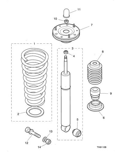

There is not supposed to be any type of snap ring on the shock. The bump you are pointing to in the picture is actually part of the shock body. The spring pan (6) is supposed to sit on it directly. Something is not right if you have a snap ring in there.

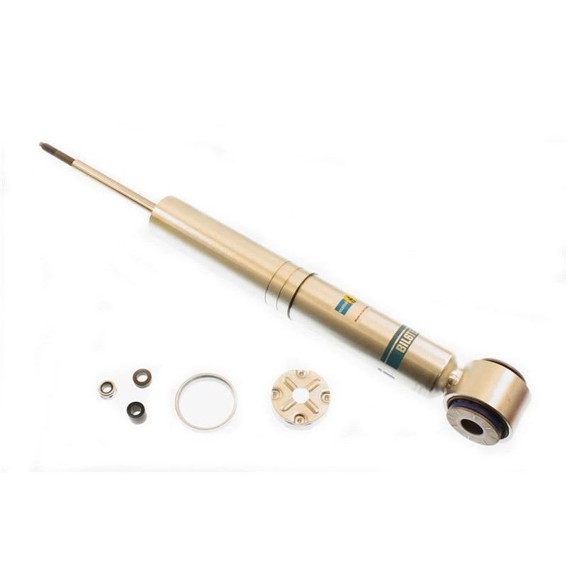

Hmm... If that’s so, then my shock is aftermarket even though it says Jaguar Bilstein? Mine had two grooves for snap rings and no bump.
I drove it today and everything felt great. The car is sitting quite a bit taller than it used to. The current solution seems to be working nicely.
After some googling, it seems I have height adjustable shocks in the front...
WTF?
This is similar to what my shocks look like, but they are black:
The snap rings go on either of those two grooves. Apparently the lower groove is for a lower ride height, and the higher groove for a taller ride height. When my antiroll bar links arrive, I'll check to see if I can see the part number of my shocks to see what we can learn about them.
However, everything I find about snap ring height adjustable Bilstein shock absorbers is that they are meant for off-road capable SUVs...
Could this be a custom made shock absorber?

My Bilsteins have the snap ring as well, not a bump.
Someone might have cut the second groove in yours. It's pretty common in the larger world of cardom. I was considering doing the same. And no, it doesn't weaken the shock folks!
