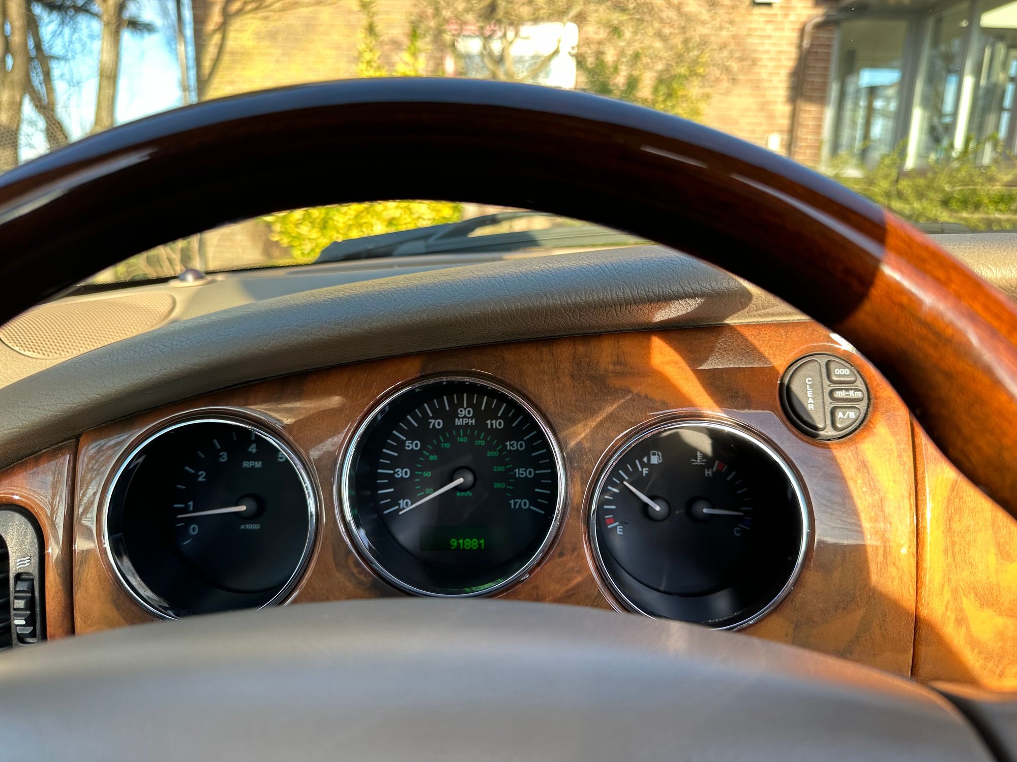

Today I fitted the new seatbelt buckle and reset the vapour leak code with my IDS. For the first time not a single warning light. Wonder how long it will last!
