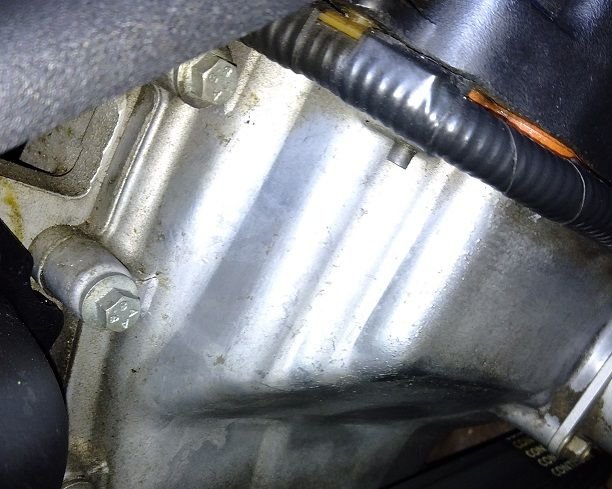

Thanks, Graham:- I had to go and check.
Current occupant:- Clearly didn't take enough notice as I guess it could be silver/grey paint. It still has its green tag:
My apologies for the dud information

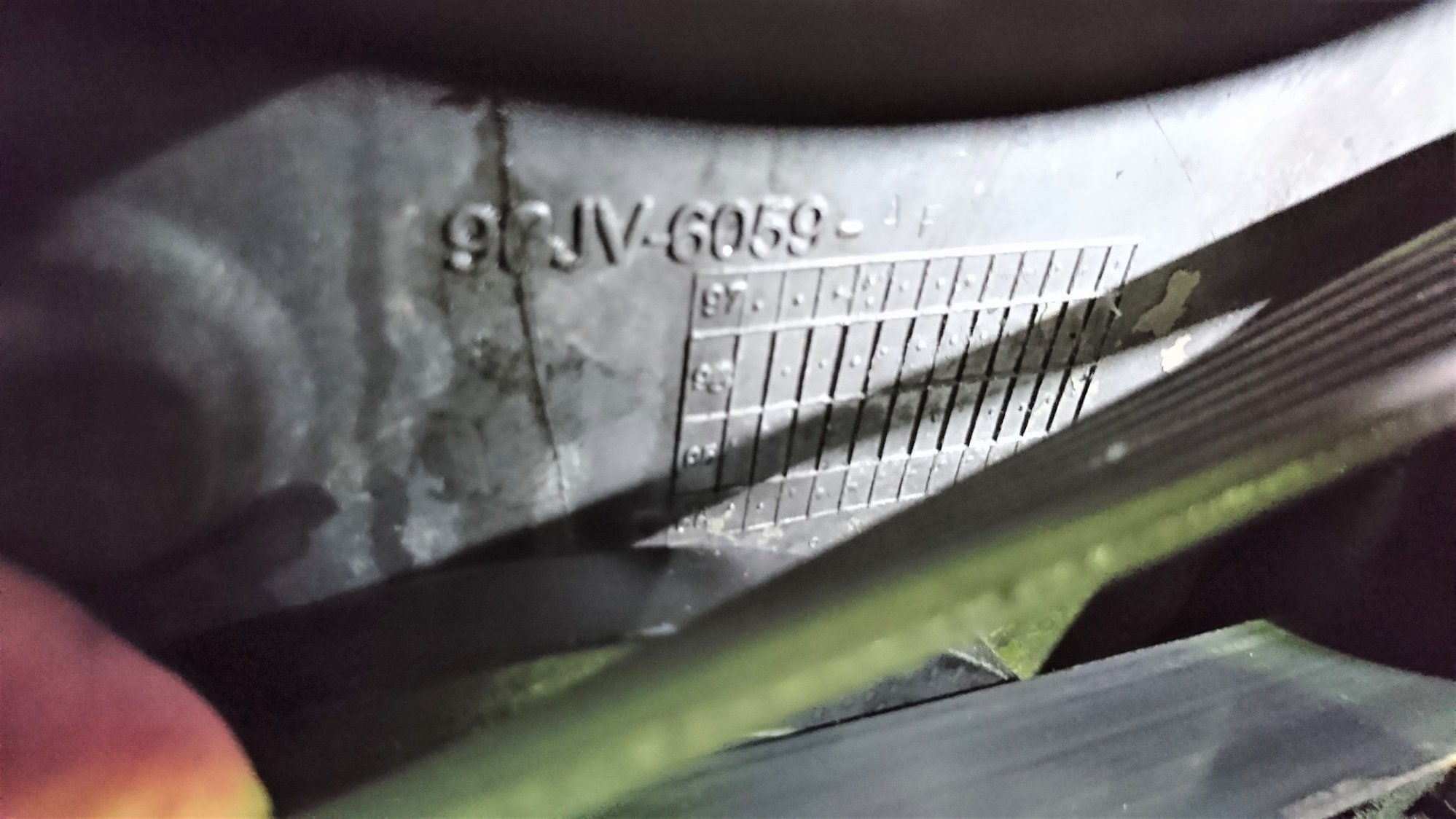

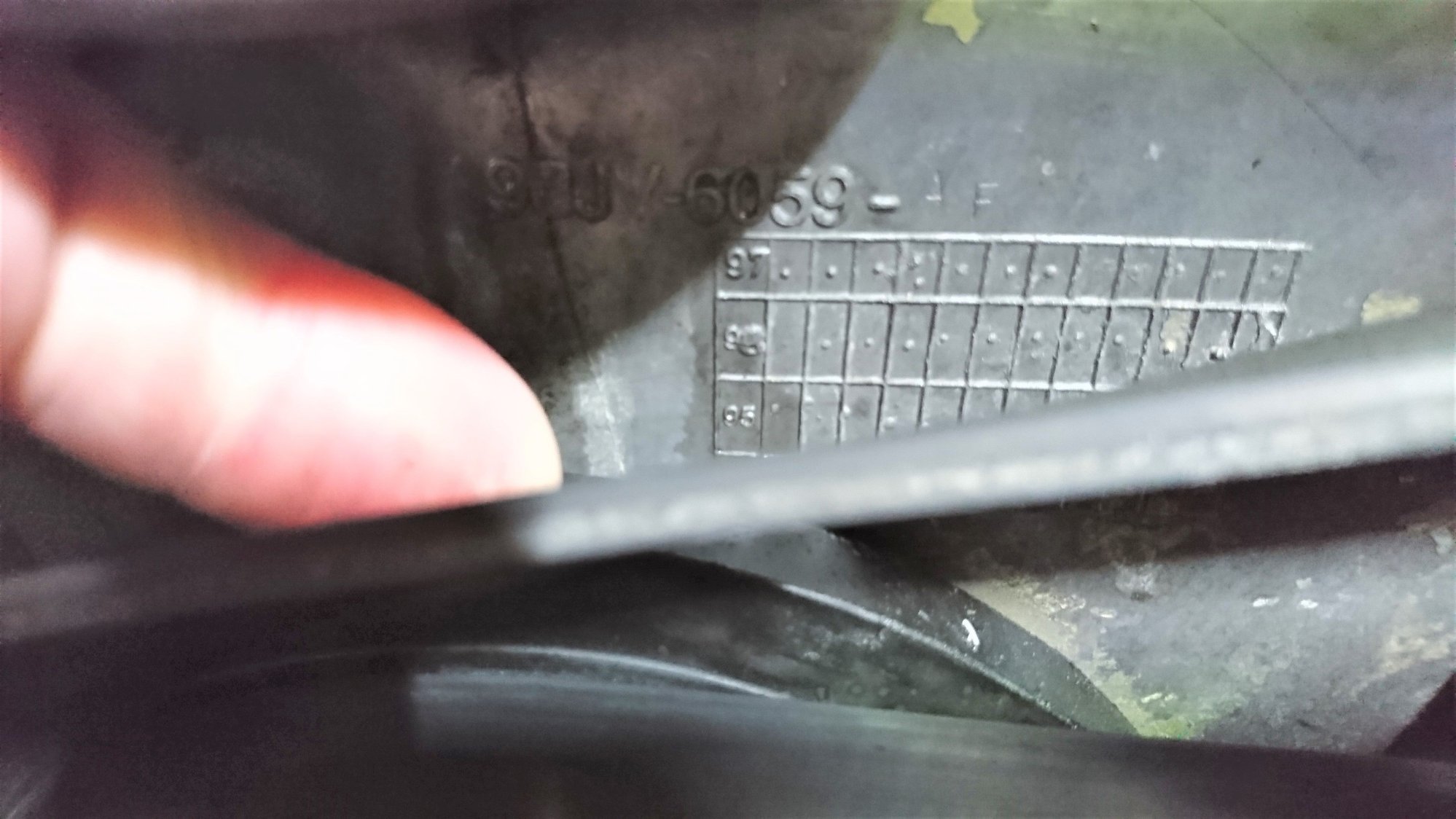

Next job may be finding out more about this refurbed engine. I do have one photo from the chain cover I took today which reads 97JV-6059- mean anything to you guys?
see pics and thanks again. The cover has been cleaned up a bit but it had the same flakey pale gold paint on it as the engine so presuming they came at the same time

If you have bits missing from the primary guides, I'd suggest you ask the mechanic to drop the sump and give it a good clean out. The detritus from the decomposing parts can end up in the oil pump strainer: See this post of Terry Young's:
https://www.jaguarforums.com/forum/x...1/#post2112274
You wil find the engine number (and hence its build date) on the top of the motor on the RHS (looking front to rear) of the thermostat tower. See this post from GGG:
https://www.jaguarforums.com/forum/x...34/#post868184

Hello, bit confused as to why they want engine number from my car if that is what I am trying to find out from them and I quote.
Applicants are required to supply all the original numbers from the vehicle, including the chassis/VIN and engine, body and gearbox numbers,
