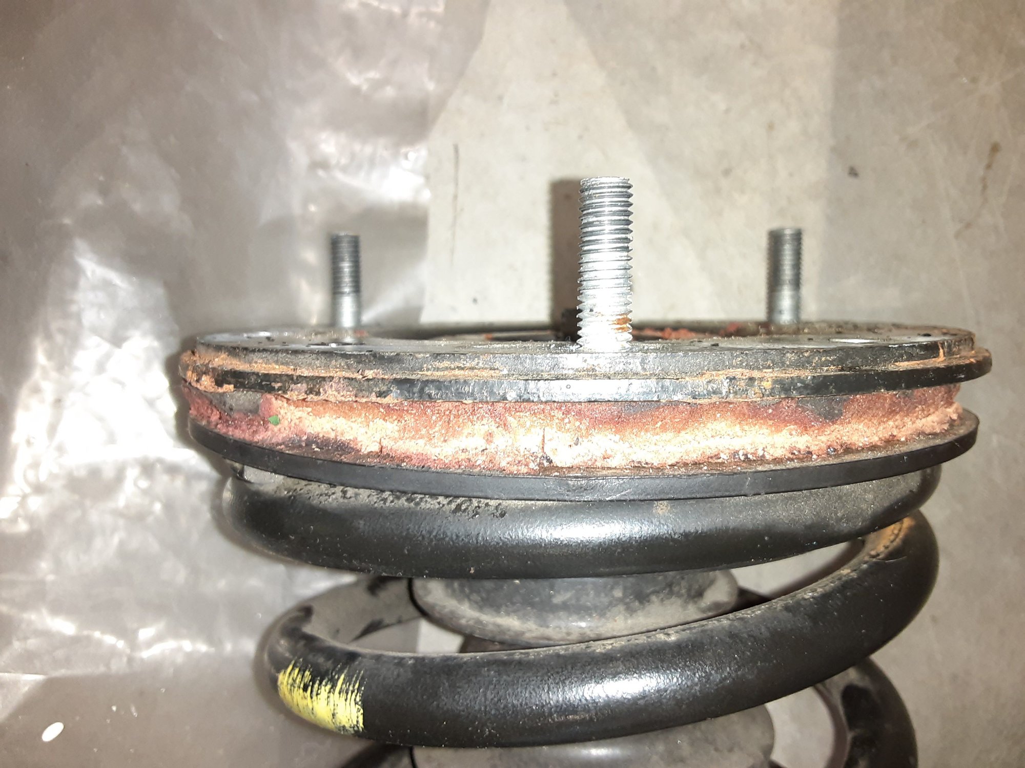

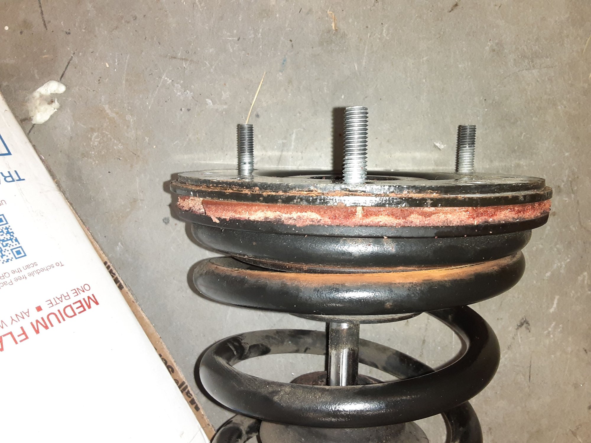

The front shock upper bushings showed some degradation when I bought my car back in June, so I knew it would be a job to be done soon. Car had 39,192 miles on it when I bought it. But the shocks started to go off center not too long after and at 40,000 miles I decided to replace them. I was not getting the metal slapping noises that some report when these go bad, but the camber was visually excessive. Having seen the VERY long thread from Wayne (cjd777 "Top Shock Mount Issue") which, with nearly 18,000 views, I am sure everyone on the forum has seen by now, I contacted him to see if he could supply a set of his modifed bushings. He was very happy to do so and I was very glad. I brought my shock towers to him on Saturday and we replaced them in his garage. We were going to replace springs as well, but after special ordering springs from SNG Barrat, found out they would not likely be here in a hurry. That's another story. So, old springs, new bushings, and we did replace the lower shock mounts as well.
Left side
Right side
The results were impressive. The ride quality and shake in the steering over bumps and ripples in the road is greatly improved and, even better (and I really don't understand how this works), the ride height went from 14 3/4 to 15 3/4 inches without the new springs. It may settle a bit more, but I have 130 miles on the car since installation. We replaced the bushings which are 5/8" and added a rubber spacer 1/4" between the top flange of the shock mount and the inner fender to further isolate vibration from the road and to give it a little more height. But the old bushings were not completely collapsed yet unless they were under the weight of the car. Maybe some of the height loss was also due to the lower bushings wearing also.

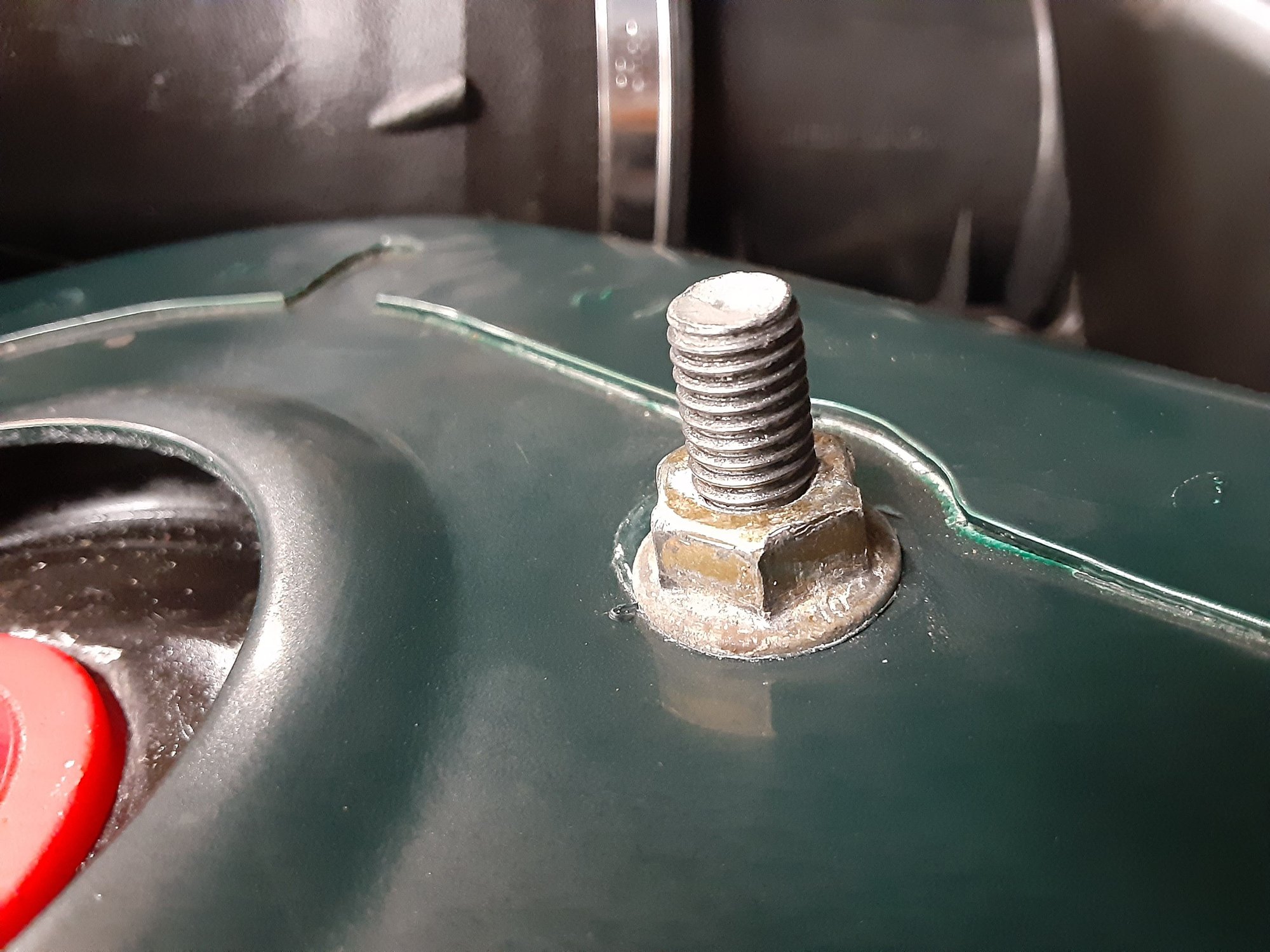

The only problem I noticed, and I discussed this with Wayne, was on torqueing the 3 nuts on the top of the tower, the inner fender did dimple a bit, due to the compression of the spacer underneath locally. This could be remedied with either higher durometer material or an aluminum rather than rubber spacer, or maybe some washers under those flanged nuts to spread the load a bit. I thought about fender washers but after looking at it, there isn't room for that large a washer. If I had new springs, I would not have put the spacer there to begin with, but as it turned out everything looks great.
The materials Wayne is using for the bushings is certain to be much more durable than just about anything else out there, and, almost forgot, credit also to Baxtor for the inner bell bushing design! I know this was a collaborative effort with input from many and we are lucky to have people like this and this forum. Thank you Wayne, Baxtor, and anyone else involved in this development!
