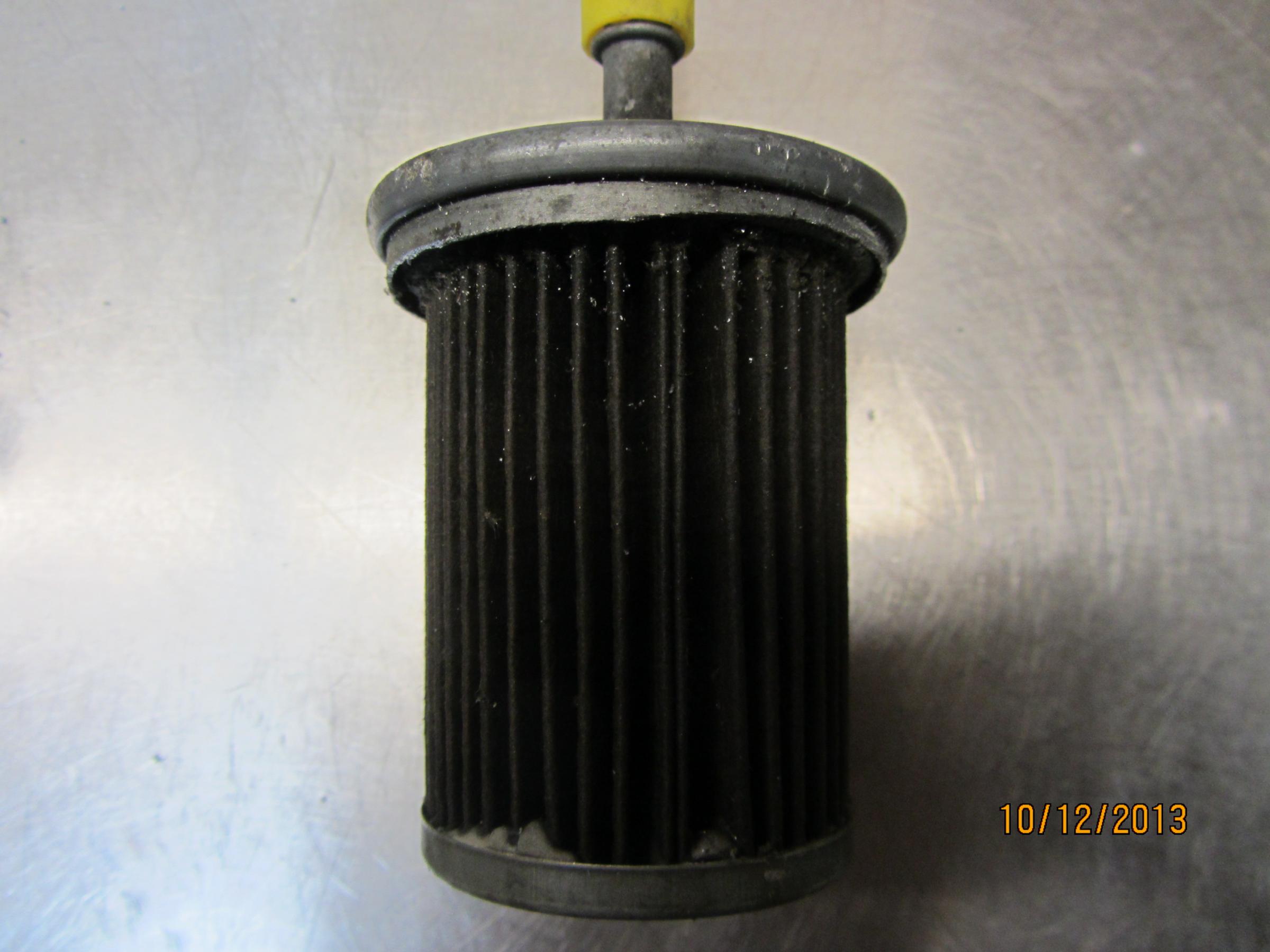

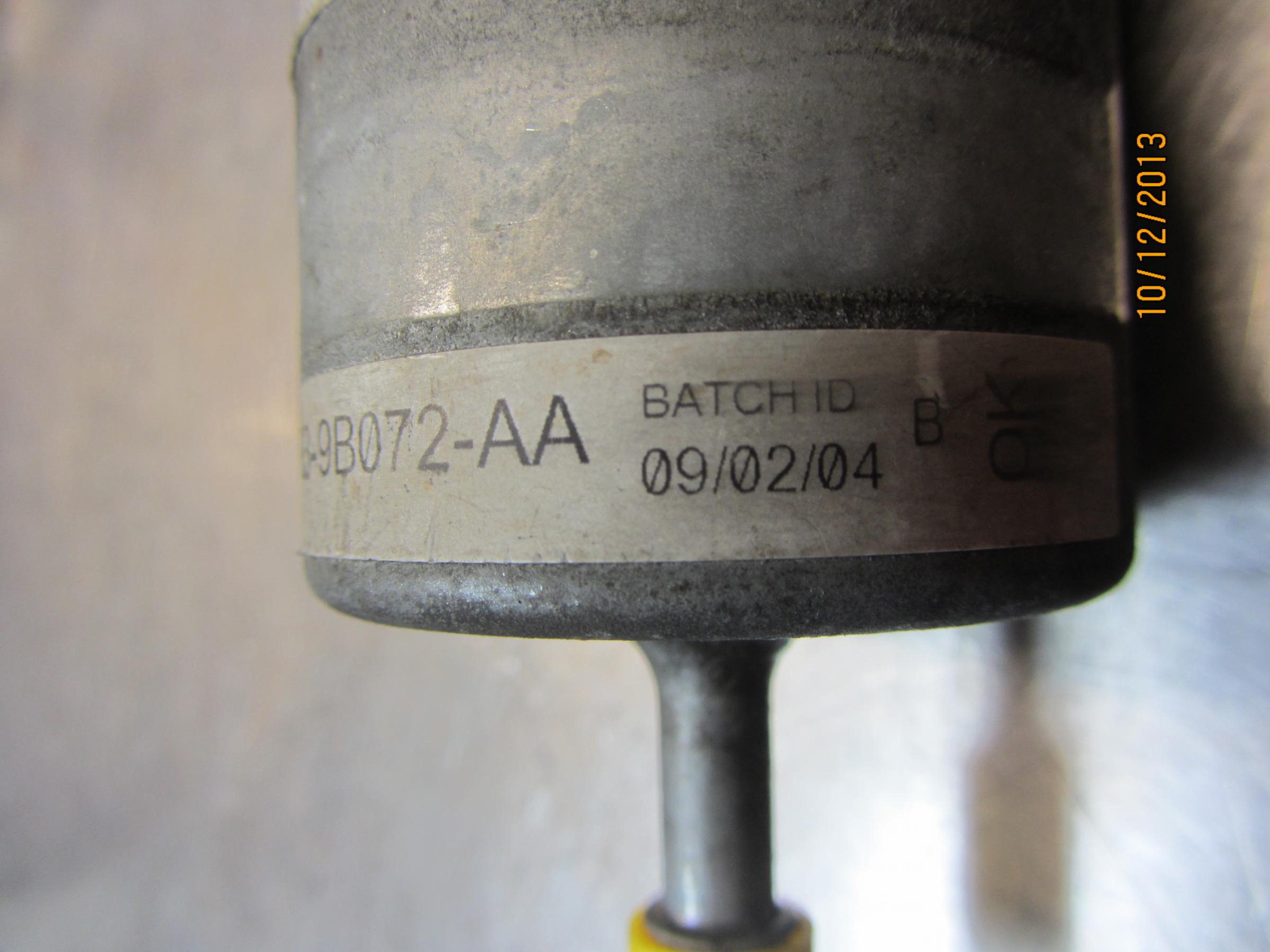

I replaced the original fuel filter on my 2005 XK8 today. It appears that the fuel filter on the car was the original one, with 74,672 miles. The filter uses the quick connect fittings, and not the threaded fittings like earlier XK8s have. Here's photos of the original fuel filter. Note the date on the filter label (9/02/04).

The crud that came out of the old fuel filter made me wonder how any fuel was able to flow at all. Lots of fine, black granules came out of the in-flow end with the gasoline remaining in the filter. I cut the old fuel filter open and the paper pleats inside were black, and there was a lot more black particulate matter at the out-flow end of the filter. I imagine my fuel pump will be breathing a sigh of relief now, not having to fight to push fuel through an obviously constrained filter anymore.

Pix of the paper pleats please.
