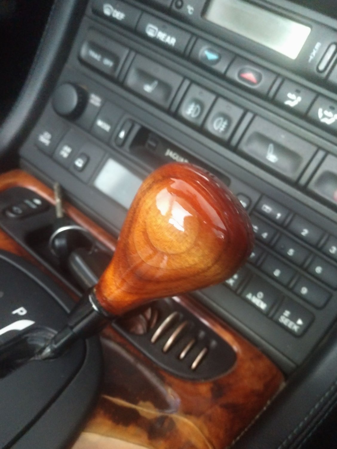

I did same recently but was not happy with the slight orange peel or depth from spray lacquer [Duplicolor] after 8X coats. So 600 wet sanding made it smooth and I dipped twice in a can of oil base clear high gloss lacquer. Result was almost perfection. Just a wave at the bottom hardly noticeable.

The shift knob came out darker than the shift console and mine had a few cracks so I did same to it. Heat gun & sanding to remove the lacquer, stain & many brush coats of lacquer. I 'like' the result as the wood colours match but have a few brush marks [some of the blemishes in the pic are shadows]. I'll let it harden, wet sand smooth and set up a pan [tin baking tray] and try pouring the lacquer. Yes, I have the plastic shift trim bit to glue back on buts that's another project for another weekend.
