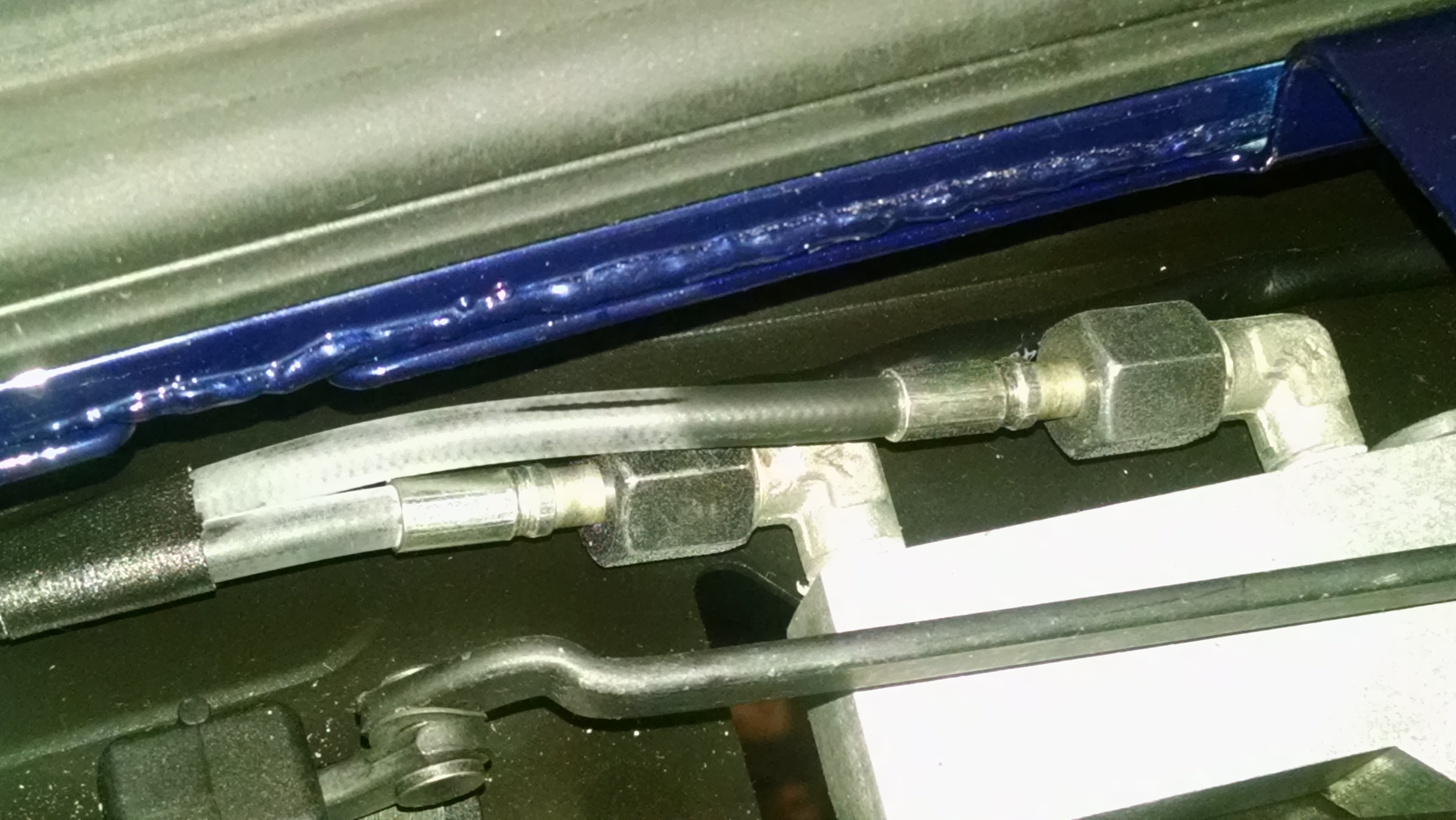

Noticed some green hydraulic fluid below the convertible latch yesterday. Just a drip. I'm well aware of the hose failure problem and, since the weather is going to be crappy for the next 10 days, I thought it would be a good time to proactively tackle the job befor it turns into a shower. Upon inspection, the hoses look great (see pic). The fluid seems to be coming from the ram.
So, I am going to get the ram rebuilt but I'm wondering if I should do the hoses as well, especially as it's a much bigger job and another $300. My understanding is that the hose failure occurs more frequently in hot climates.......which is not what we have in north Idaho!

I would replace the hoses also, and take a good look at the rams. It's a lot of work, and not inexpensive, but if you plan on keeping the car.....

The hoses look good in the photo but would give a good inspection when you remove the latch. Be sure not to bend or tug on them when you do the R&R on the latch and leave them. Do you have a pressure reduction system on the roof hydraulics?

Hoses appear to be in excellent shape ... cold climate ... there's no reason to think the hoses are not serviceable, maybe indefinitely.
it's a big job to replace them (reports say, no first-hand knowledge) and other things can get disturbed in the process.

I did this a few years ago. Replacing the hose is at least 8 hrs the first time you do it. ( I had to do it twice due to a defective new hose!). If I were you and had high confidence that the hoses were good, I would only do the ram now (use "top hydraulics") and plan to do the hoses and rear Rams later. If the front ram is leaking, the rear ones are probably not far behind since they see the same cycles and pressures. BTW, The second time is much faster.

Thanks for all the comments and opinions. After some consideration, I've decided to repair the leaky ram only since the hoses look perfect. I sent the part to Top Hydraulics on Friday, they will have it Monday and said they will be shipping it back on Tuesday. Great service!
I've had the "resistor method" pressure fix on the pump since I bought the car in late 2012, but I realize that that is not a perfect solution. So, next I'm going to install one of Gus's pressure reduction valves on the pump. Cost is about the same as new latch hoses, way less installation time, and should keep the pressure down on all the components including the rear cylinders and hoses - hopefully extending their life as long as I keep the car.
One other interesting observation: after tearing apart the the area above the windshield to get the ram out, I'm guessing that this is the bulk of the work for a hose replacment job- all that's left is pulling the front seat, console, rear seat, and running the new hoses. I could be wrong.
