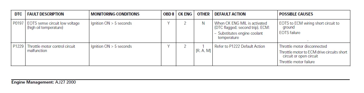

Brian - what year is your cat as that will help the experts with diagnosis (adding to your signature line helps). The JTIS is also available for download under the how-to's which has the codes - below is what I found
P0197 EOTS sense circuit low voltage (high oil temp)
EOTS to ECM wiring short circuit to ground
EOTS failure
P1229 Throttle motor control circuit malfunction
EOTS failure
Throttle motor disconnected
Throttle motor to ECM drive circuits:
short circuit or open circuit
ECM ground circuit fault(s) (EM80-004, 005,054)
Throttle motor failure
Throttle body failureThrottle motor to ECM drive circuits:

The throttle body motor being 'diconnected' or shorted to the computer may be your simple answer. You will not be able to clear that code until its actually fixed in the eyes of your ECM.
Since you've had the TB off the chances are you've not reconnected the connectors properly as the others have suggested.
Give them a good clean and reseat and hopefully that will fix things.
