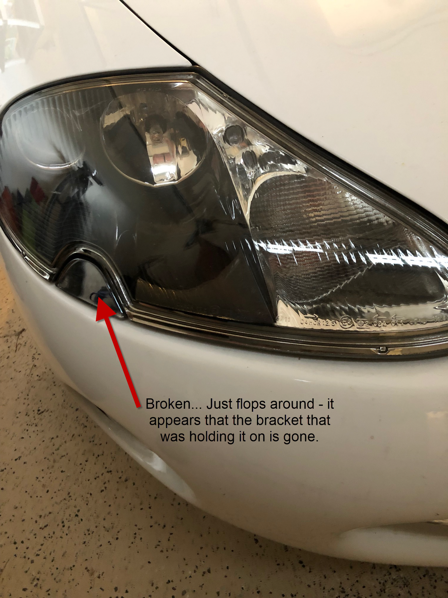

Ok, so a bunch of plastic crap flew up and hit the front of my XK. There is a small mirror thing under the headlamp. It seems to be just flopping around and it appears to be held in with some sort of bracket that is now missing.
What is this thing?
Suggestions on fixing?
Thoughts??

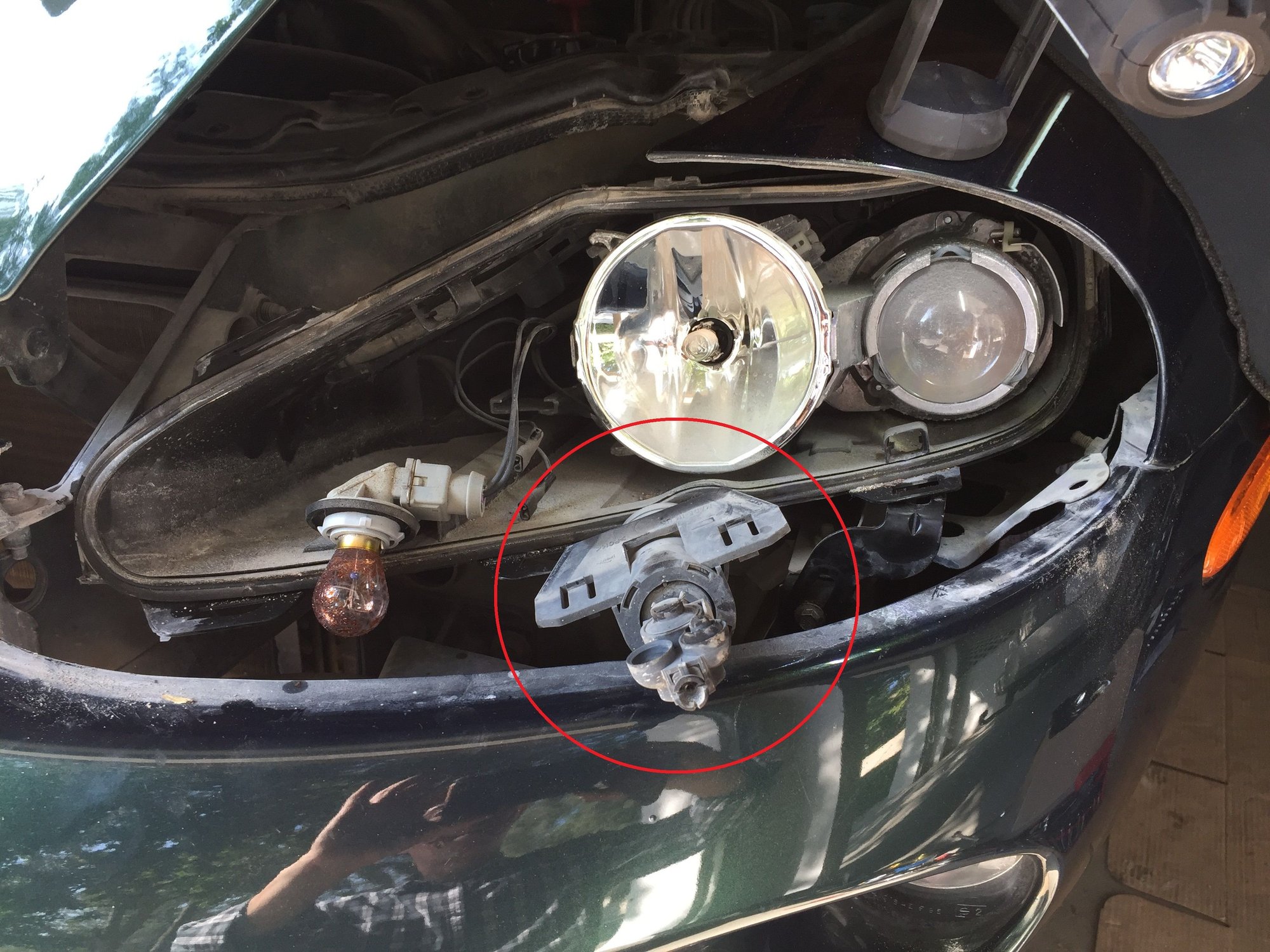

Here's a picture that may clarify what people are saying above. The head lamp unit comes in two halves and this is the view with the front half out of the car. The power washer unit is circled and it's triangular mount slots into a recess at the base of the headlamp. The mirror cover pops on the front ball joint of the power washer unit. It's a plastic ball so this may just need padding out to firm up the mirror cover. Or it may just be that the power washer unit has come out of the recess and is wobbling about. Maybe it'll slot back in but will be fiddly with no working space. Lots of info on this forum on how to remove the head lamp unit from the wheel well - i remember a really tough torque screw at the bottom which requires blind working! Had to do this job a few times when I "accidentally" lost my mirror cover (one of my numerous "Doh! Don't do this moments!"

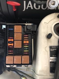

I was trying to find - is there a simple way to disable the washers. I found a thread about pulling the fuse, but no one confirmed it was the right one, etc. I really don't need them, never knew I had them for the last x years...
Old Jun 12, 2020 | 12:18 PM
michaelh's Avatar
Posts: 4,814
Likes: 3,029
From: Jersey, Channel Islands

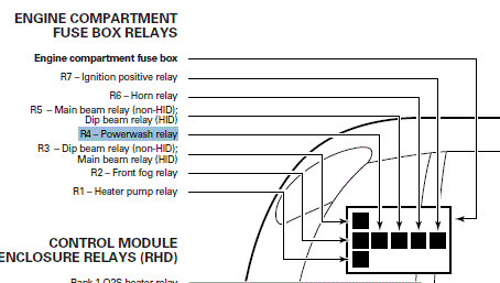

You can pull Relay #4 in the engine compartment fusebox:
The 2003 electrical diagram also shows F7 (30A) in series with the pump.

Thanks! I am going to first attempt to fix and if that does not work, then I'll use clear silicone caulk to keep things from moving around.... In the meantime I did pull the relay..
I have not tested it yet but I will later this weekend.
