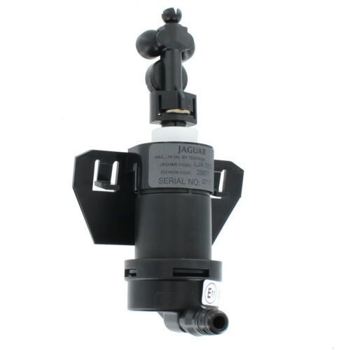

Had issue with front offside headlight power washer in as much as it began to leak washer fluid. I obtained a replacement from my local Jaguar dealer (part no. LJA7050AF) and fitted it correctly.........however, when fitted I found that the front chrome end piece was not flush with the headlight by around 6-7mm. Has anyone had this problem?

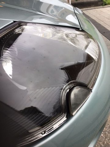

Sorry to be so late to contribute, but I just ran across this thread and thought this info would be helpful to future readers. The reason the cover of a new headlamp washer jet will not fully retract is that the jets are shipped with a white plastic C-shaped restraining collar that prevents the moving nozzle shaft from fully retracting. I do not know the purpose of this collar, but perhaps it protects the internal valve from damage during shipment.

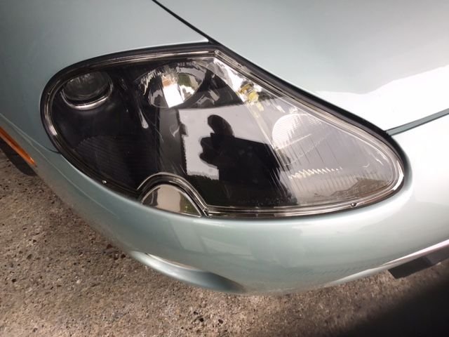

The white collar must be removed prior to installation of the jet. Here are a couple of photos showing the jet in situ on the underside of the headlamp assembly. You can also see this collar in the photo of the new jet in Doug's first post.
With the collar installed, the jet cover at the top of the image protrudes beyond the headlamp lens:
With the collar removed, the jet cover retracts fully:
