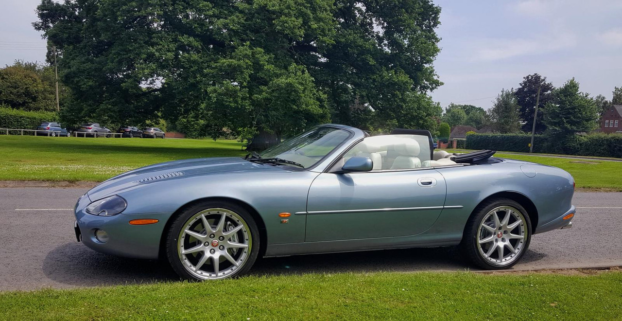

This is mine outside of one of my local pubs, the Swan at Hanley Swan.

I can also show you the weak points and why a XKR is a much better car.This is mine outside of one of my local pubs, the Swan at Hanley Swan.
