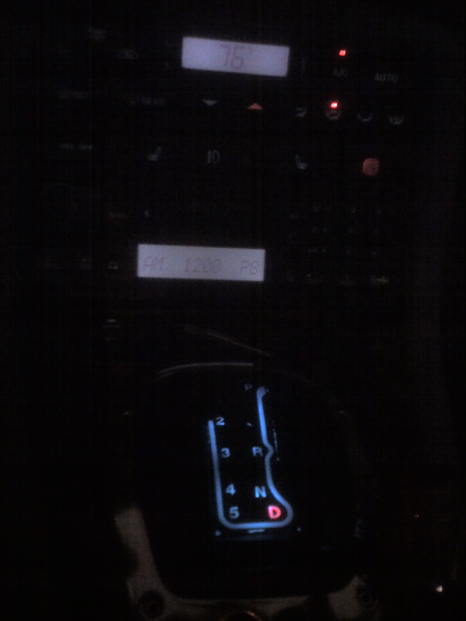

Default J-Gate LED Illumination
Here is the picture of my Shifter J-Gate as currently illuminated by the LEDs that I installed.
