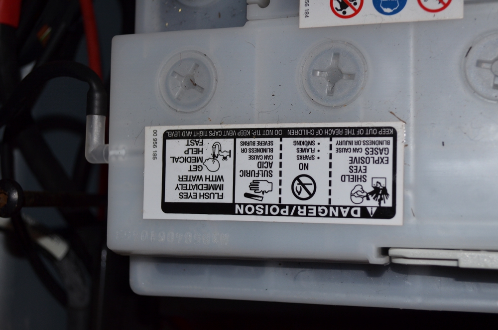

The tube is a vent pipe for the battery, it plugs in the top rail of your battery if so designed. Some have the hole but need to be drilled out. A good idea to get it working.
Wayne
Old Apr 11, 2015 | 09:22 AM
You can ignore the electrical connections - they are for equipment not fitted to your vehicle.
The Vent Pipe (item 1) is important.
It should be connected to the left side of the battery to vent potentially explosive gas to the outside of the vehicle.
