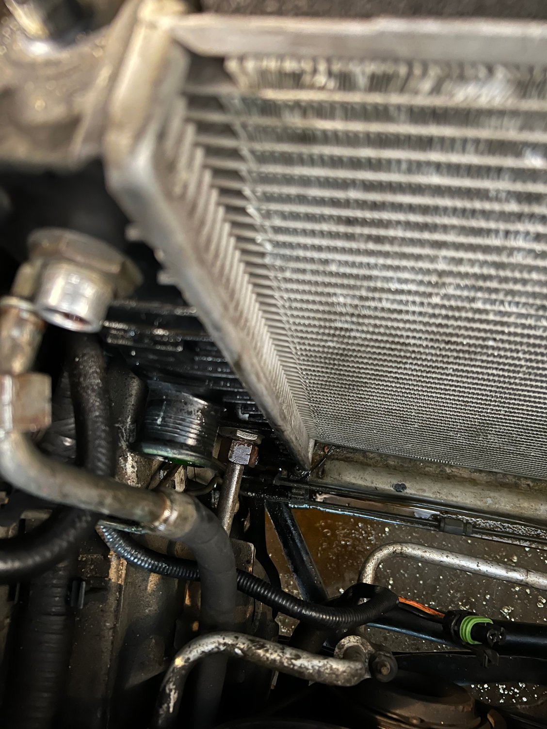

Replacing radiator. Top transmission cooler nut came off with some effort. Bottom won’t budge. Tried soaking with BP Blaster and butane torch. Hints?

Just muscle worked in the end. Though the fender I was leaning over was going to collapse from the force
