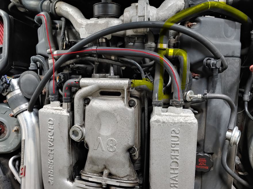

I'm planning to do a complete overhaul on the cooling system, so I am collecting part numbers and this is where I got stuck: red, red (dotted) & yellow hoses.

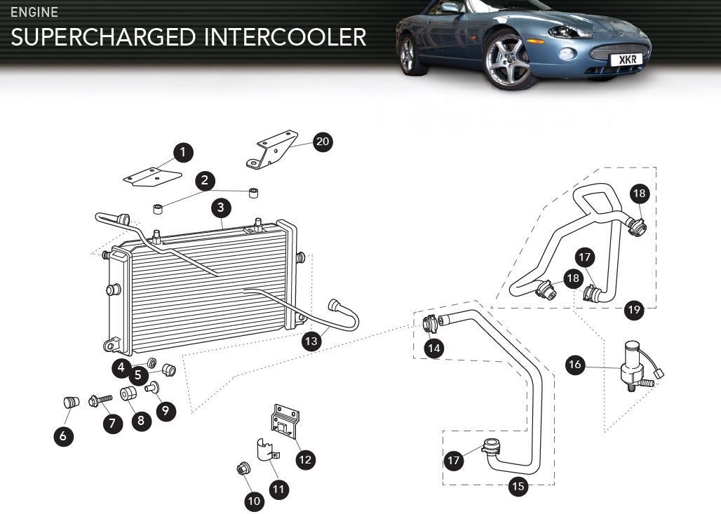

And this is from BARRATT's catalogue:
Am I looking at the correct diagram? Can anybody help me identify these hoses? Thanks in advance.

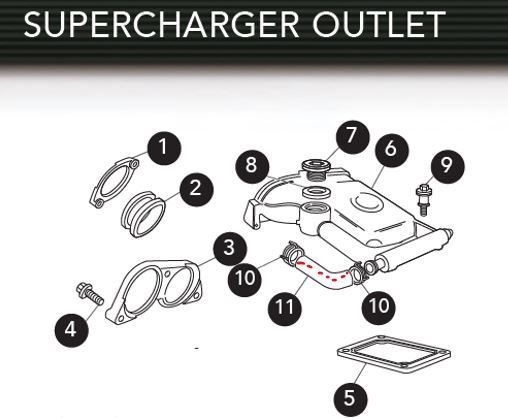

I found the dotted red hose... part # NCC7723AA.

Thanks to Dan @ Jagbits, the part numbers are identified.
Red hose: C2N1592 (#19 on the 1st diagram)
Yellow hose: C2N2615 (radiator lower hose)
Red dotted one: NCC7723AA (#11 on the 2nd diagram)
