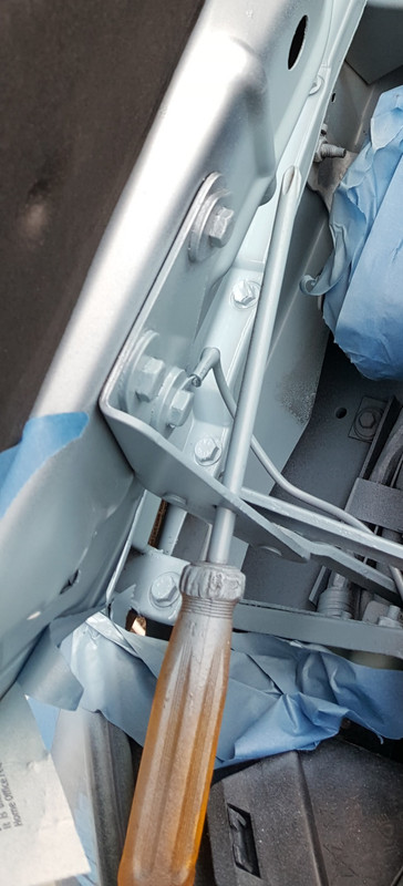

Never found it a problem myself. Remove one shock. Remove the other one whilst holding the hood. As soon as its free move it back even more and it will practically hold itself there. I had a strong pencil sized paint brush I put that in there. I have also used a long screwdriver, that seems to work the best. If you use a nut you have to undo it, normally a two hand job. A screwdriver you simply pull it out and drop it on the floor.
Good idea about the blanket. I have used one in the past to rest the hood on. My struts are strong enough to hold the hood with just one. As you say though you can remove one. Lower the hood. Go around the other side and remove the other. No biggy
The photo below was during a clean up and repaint.
