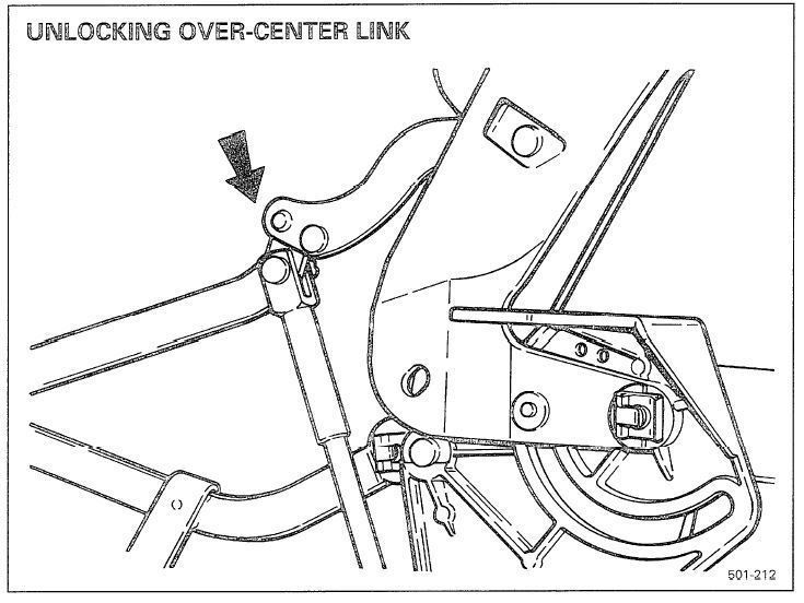

Is there a trick yo getting the top down manually? The latch is undone, butterfly valve on the pump open, i cant get it down.
I guess I need to find this center link....

They are on both sides of the roof . You can see them from the rear seat on the left and right.

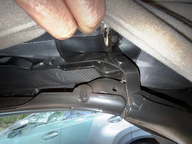

I must be an idiot. Is this it? It looks totally different from the diagram above.
look for the solver ram shaft reaching up to the linkage near the back corner of the rear seat.
