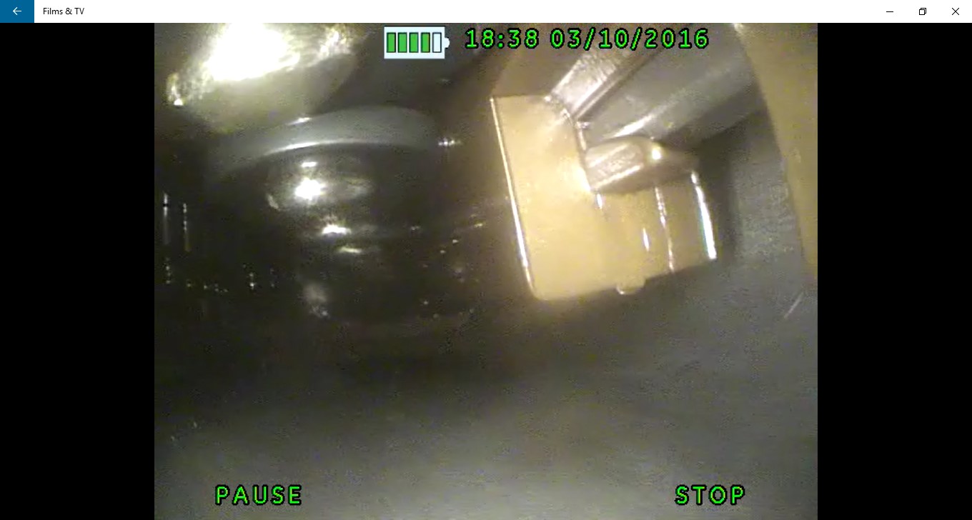

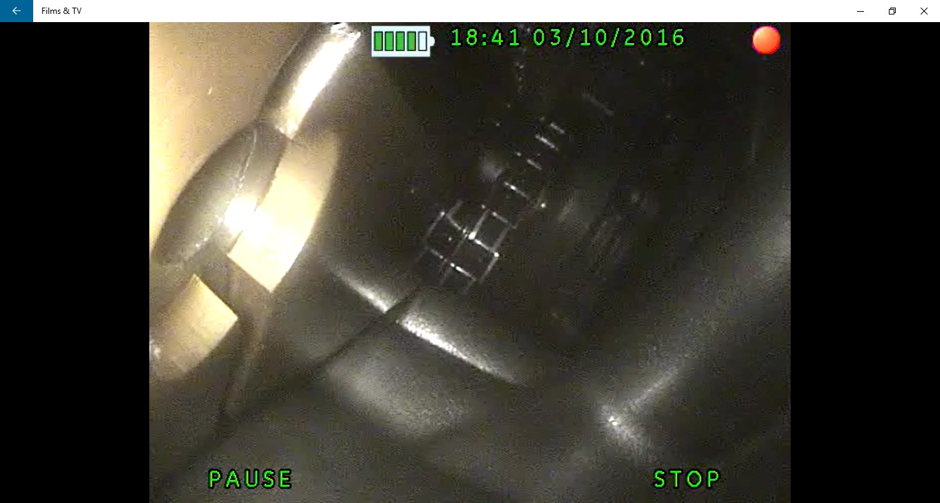

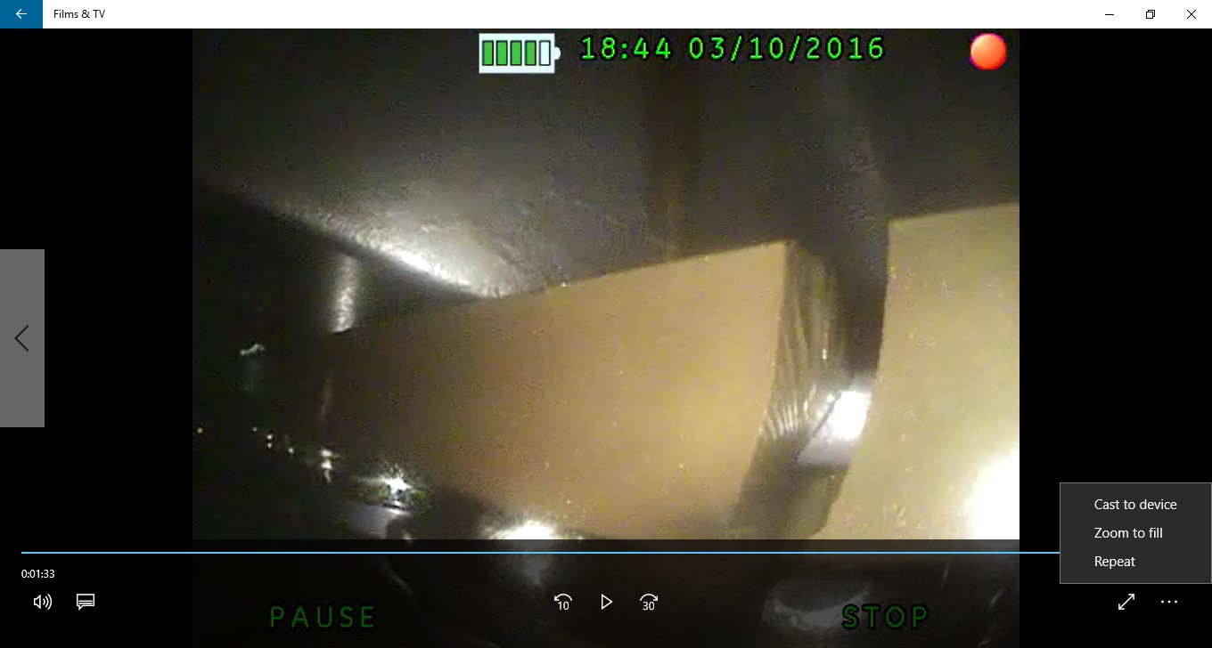

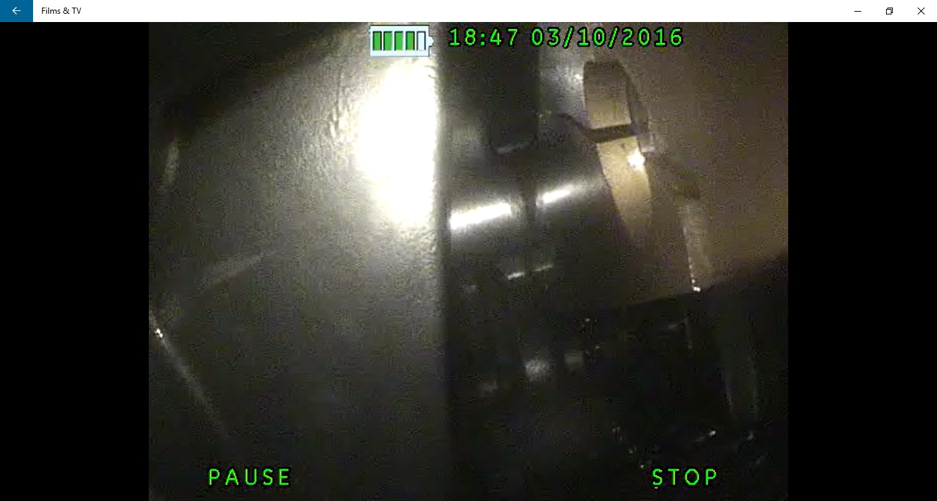

Warning, these are not for the faint hearted. If you thought only the secondary tensioners were an issue you will opt for the full change after seeing these:
If your VVT solenoids are mounted on the timing cover, then its a simple matter of poping off the 30mm (or so) diameter blanking cap on the cam covers and boroscope the chains and guides. I only started out trying sort out an oil leak but i thought while I was in there I'd take a look. Looks like a piece has already dropped off and whats left is only just hanging on.

They were screen dumps from a bespoke movie format, so I just pasted them onto a word document, they should open in word

Attached Thumbnails horror pictures-guide1.jpg   horror pictures-guide2.jpg   horror pictures-guide3.jpg   horror pictures-guide4.jpg

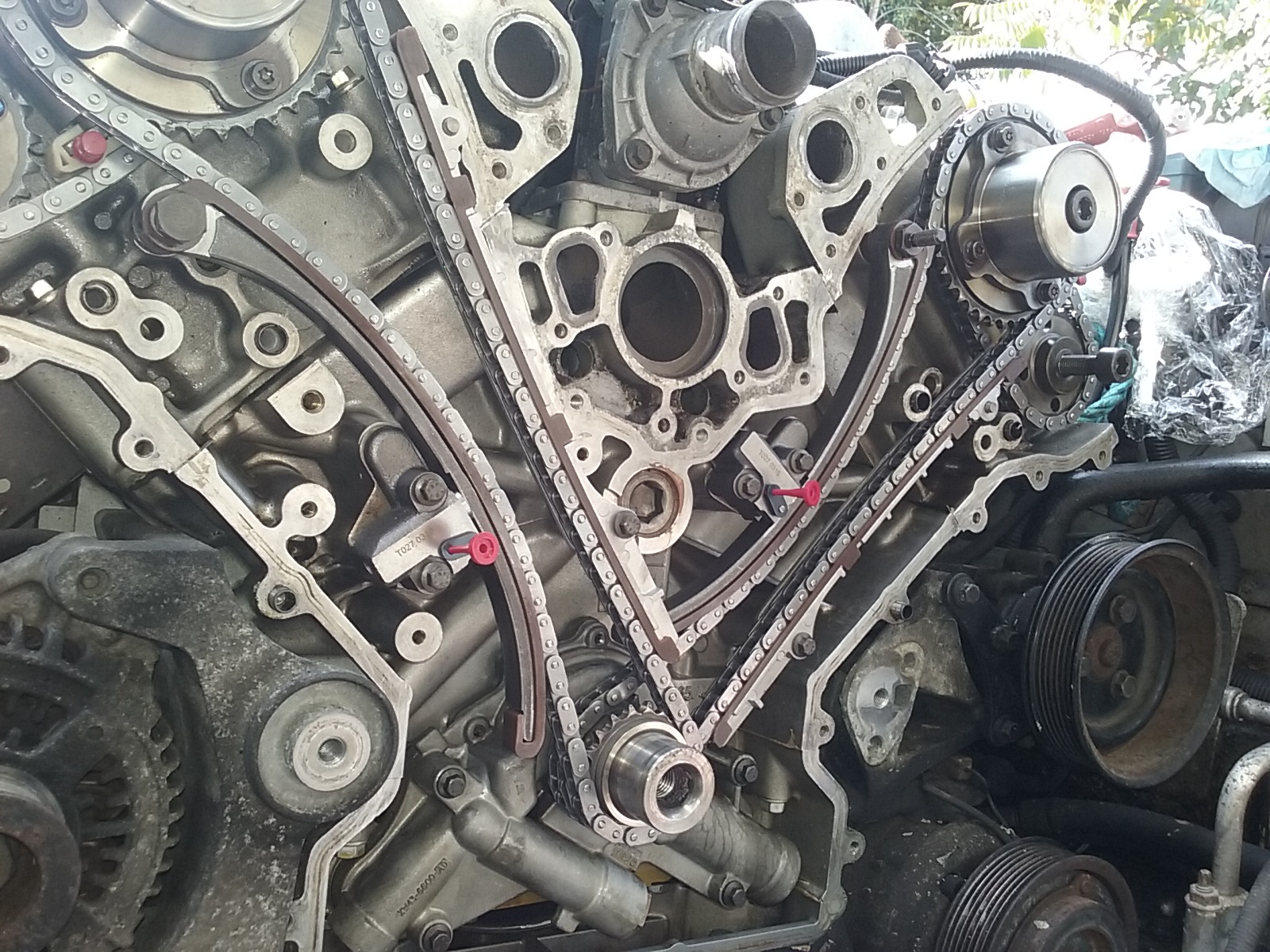

Got the chains on now, just need everything tightening. I had an issue with the locking peg for the flywheel. It just wouldn't go in, not convinced that it is the correct size but after tapering it slightly it has just started but not in fully. The timing mark was half a segment retarded as well! not sure what that equates to in degrees but I had an issue prior that the car wasn't that responsive in low revs, hopefully I've just found the reason? The A bank primary chain was slack on disassembly, looks like the tensioner was stuck, it was about 3mm less extended than the B bank and I had a small amount of chain slap on overrun. Its good to find the reasons for issues
