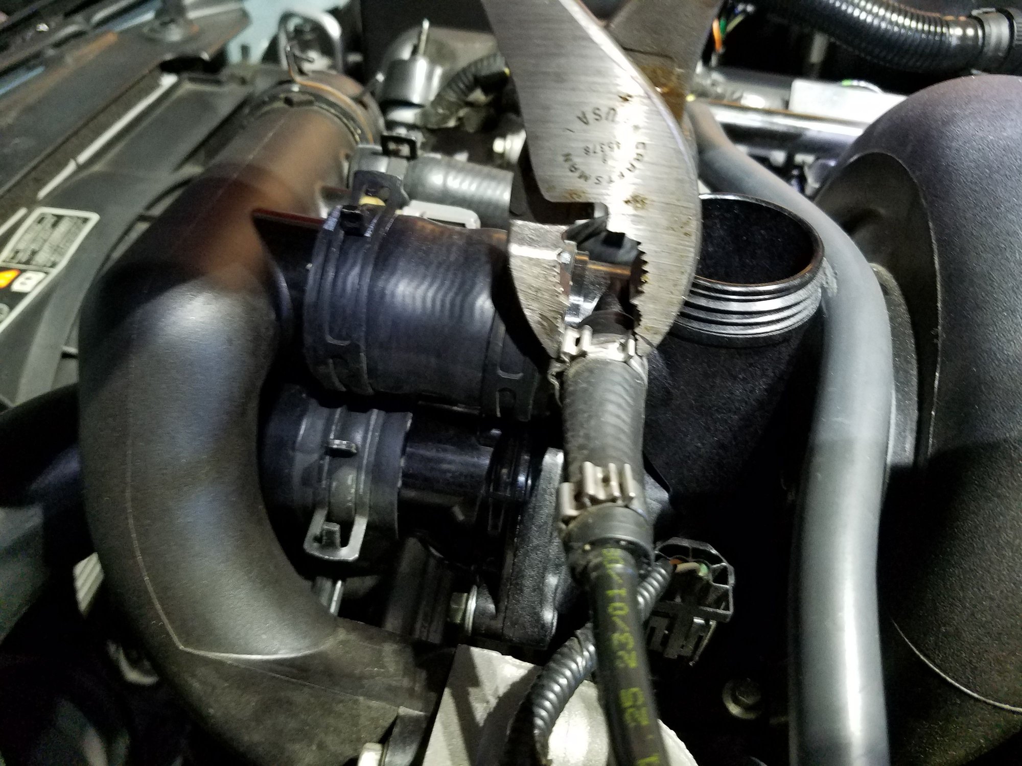

What is the correct way to release this type of clamp”
wish I was competent enough to post a a video (will try tomorrow) as a picture is worth a thousand words.
i just use a very small slip joint pliers (channel lock) and gently squeeze together the two “humps” that are farthest apart until the “hook” is away from its catch. Then I position a tiny flat blade screwdriver against the catch and release the pliers. The screwdriver keeps the hook from going back where it locks in the clamp and it slides above the catch, releasing the clamping,
to reassemble, just squeeze together the two humps until the hook rides over its catch and slides down into the lock position.
There’s going to be better and more concise explanations (I hope).
Z

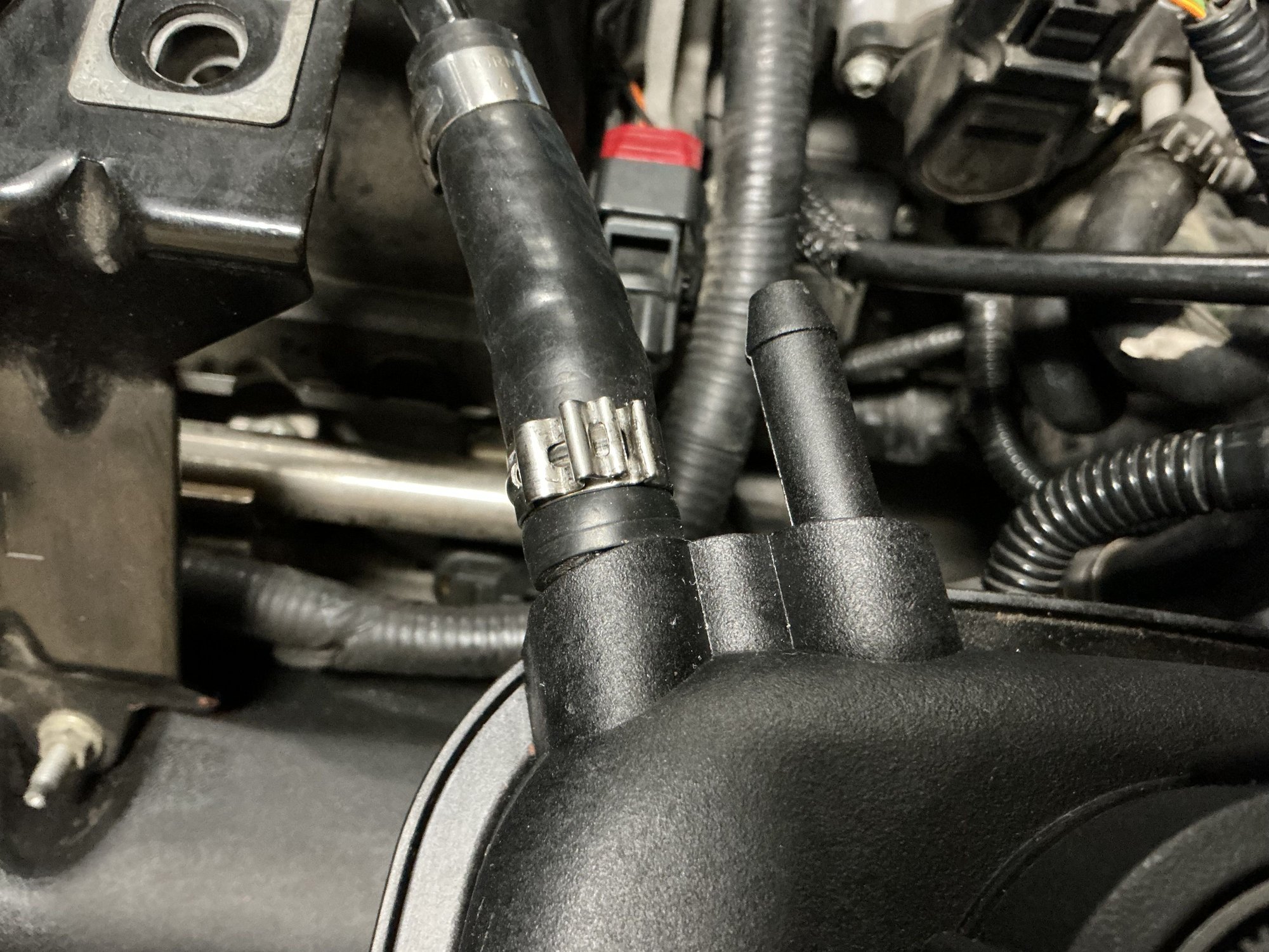

Tightening the Norma Cobra clamp after replacing the thermostat housing.. (Yes - I used the OEM plastic)
HTH, Dave
