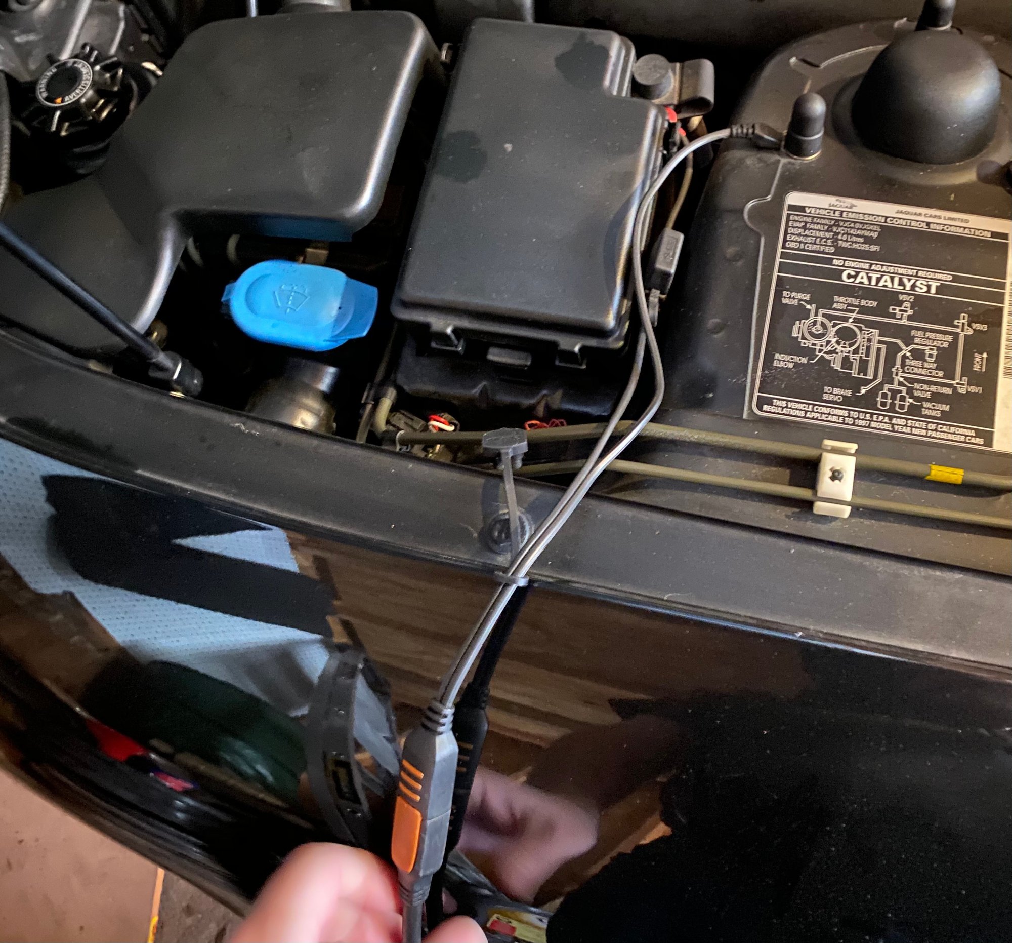

I prefer to leave my hood/bonnet open rather than the trunk/boot so I connect my CTEK up front on my 97.
+ on left to bolt under rubber flap cover. - on right attached to strut mount bolt
