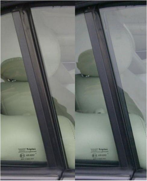

I also thought I has a rear adjustment issue but was able to solve it with only front adjustment
Before and after on mine.
What specifically did you do in terms of adjustment? My problem as been 2-fold in that in addition to front-to-back adjustment (i.e, the front window would have to move rearward and/or the quarter window would have to move forward) there is also an out-of-plane adjustment that is needed (moving front window inboard towards the interior and/or moving quarter window outboard).
The 2 easiest to get to adjustments are for the front window and are the ones Rev Sam plays with in his video. Actually those are easily accessible without needing to remove the door panel (under the puddle light and under the front speaker). I tried playing around with those but did not solve the problem. One Jaguar shop I went to thought what needed to be adjusted was the rear quarter window which is a pita.

I followed the adjustments in the manual but found that the glass was not really being held firmly in the mechanism and found that I could pull the top corner of the window backwards to close the gap, I think this did more than any of the other adjustments.
