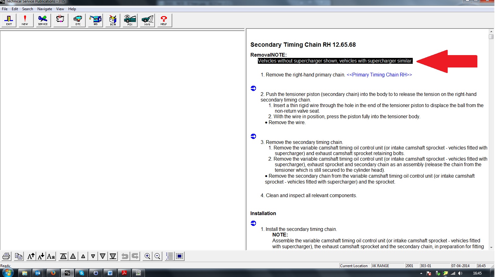

The clue is in the first line "Vehicles without supercharger shown, vehicles with supercharger similar" (arrowed in red):
JTIS was developed for use by Jaguar technicians. For this reason many procedures which they know through training and experience either aren't included or have only minimal detail.

You might need to navigate to an early model for some things.
If the introduction 1997 has a procedure, then unless it is changed or superseded, it is redundant and sometimes not repeated in later model year repair procedures.
A major change was the AJ27 engine and management so 1999 might have a more detailed procedure than a 2001 because most things are the same.
You might want to read the product introduction and UPDATE publications to see the changes as they were introduced.

This explains a lot. I thought it was random that the 1998 had a bunch of stuff not covered in the 2001 ... as if I didn't need to worry about that. Thanks!
