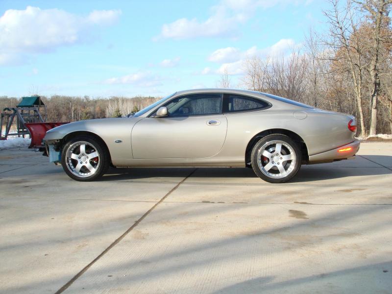

I took the afternoon off and put the wheels on today. They look good but I do need to lower the car around 1". How much does the H&R springs lower the car? Here are a few pictures. Now......... on to the front bumper.

Wow, you've got some serious tread on that car. Looks like the front is higher than the rear in the pic. Do you want to equalize the front and rear ride height when you lower it?

No, the front isn't any higher. I think because the bumper cover is not on it looks like it is. Right now the tires are a 35 series. I think I will be going to a 40 series in the front. I also will be going to a bigger tire in the back. The fronts are a 275-35-18 now( rears are the same)and I will be going to a 275-40-18. And for the new back tires they will be 315-35-18. And yes they are going to fit. Alot of planing and measuring over and over to make sure it's right.

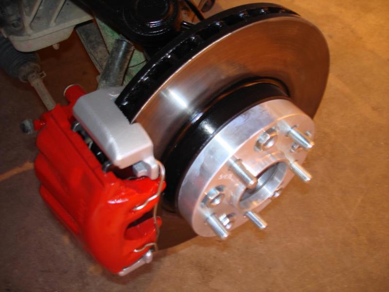

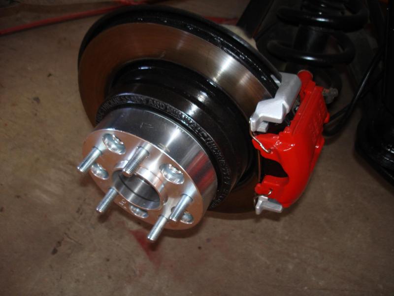

I used a 1" spacer in front and for the rear I used a 1 1/2" spacer but also add a 5mm flat spacer in the rear. I ordered the spacers for a GM to GM. 5 on 4 3/4 to 5 on 4 3/4. They are hubcentric with a 70.5 center bore. I custom machined the mounting side and opened it up to 73.8mm and bored it to .500 (1/2) deep. Alot of work but it's now coming together.

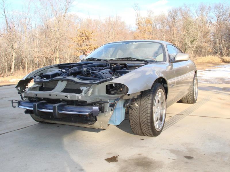

Everything will be inside and under the car. I will have to roll the lip on the rear fenders, just to be on the save side after lower it.

In the forth picture, I like the blade on the front. Getting ready for some serious plowing up there in Minnesota?

I sure could use a ALL WHEEL DRIVE XK8 here in Minnesota during the winter. Maybe something in the future from Jaguar??????????
