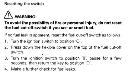

Since you still have electrical power to some areas, there is a distinct possibility that the inertia switch for the fuel pump was tripped. It is installed next to the fuses in the passenger-side fascia. When activated by a crash, it de-energizes the ignition relays in the engine compartment, and both the driver's side fascia and trunk fuse boxes. It also removes ground inputs from the BPM and windshield wiper stalk switch. This stops the engine and fuel pump, unlocks any locked door, and de-energizes unnecessary electrical systems.
Open the passenger door, pull the cover from the fuze box, then reset the inertia switch by pressing down on top of the switch (see red arrow of attached picture). Let us know if this worked!

+1

Interesting, I thought about this as a possible culprit. I was gently rear ended a few years ago and the car wouldn't hold idle afterwards and I thought the inertia switch might be to blame. Turns out it was a wire in the engine that got knocked loose.
I figured the switch needed to be hit harder than this bump to go off, and would that trigger all these warnings? Not sure but it will be added to the list of possible cures.

It's the easiest possibility to check.

Inertia switch was unlikely as the car should still crank but not start as the switch shuts off the fuel pump, not the starter.
