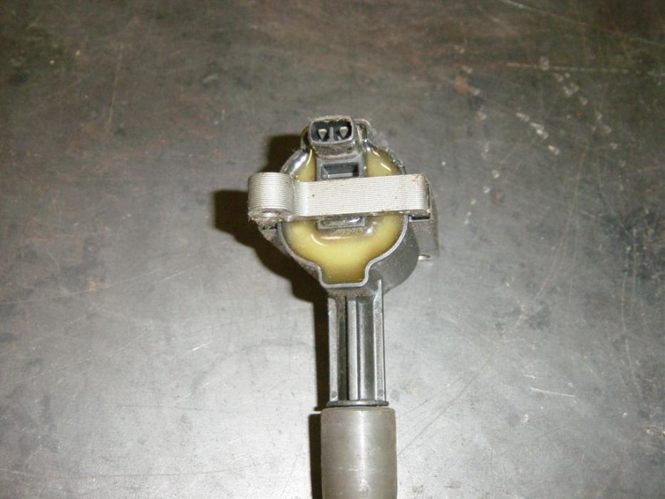

Based on the pictures my 2000XKR has the AJ26 2 pin, but it's suppose to be an AJ27 engine?

It’s kinda hard to tell if the one on the right in the picture is an AJ26 2 connector or AJ27 4 connector coil, as you can’t see the pins. Only way to check is to take of the ignition cover and count the wires going in the coils, it would be interesting to find a 2000MY (so vin Axxxxx) with a AJ26 engine.

The AJ26 connector is pictured here.
bob gauff
