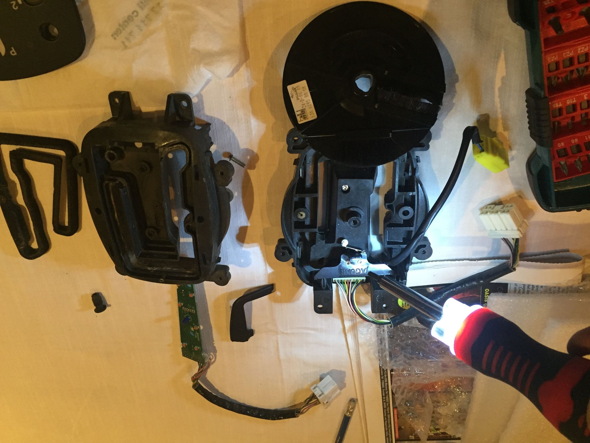

I’ve dis assembled 3 of these to make 1 working unit so maybe these old photos below will help.
It’s relatively straightforward to take apart and Rev. Sam has a youtube video to get access.
It’s been a while since I did this but I think 2 units had a problem with the microswitch shown below

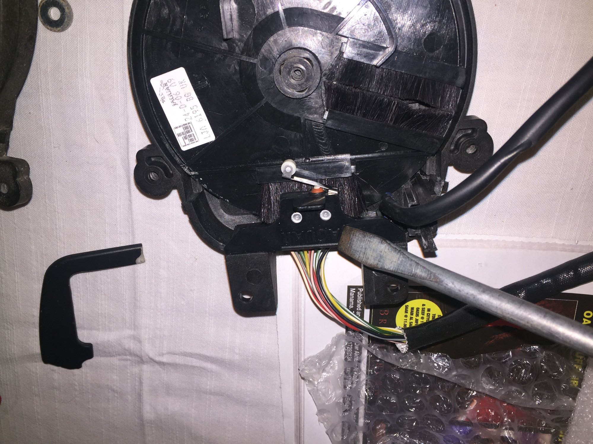

I have the j gate opened up and I see the rear micro switch lever has broken off. I’m not sure what it does. This is the 98 xk8 with the zf5hp24 transmission. The car shows “P” when in park. The car starts and drives, not throwing any OBD codes.
I was changing out the indicator plate with an aluminum plate and just s I was ready to button it up, I see the snapped off lever,
ltd
Good switch at top, broken lever on bottom switch

Seems like this is a common problem. I’m assuming it’s the neutral safety switch.

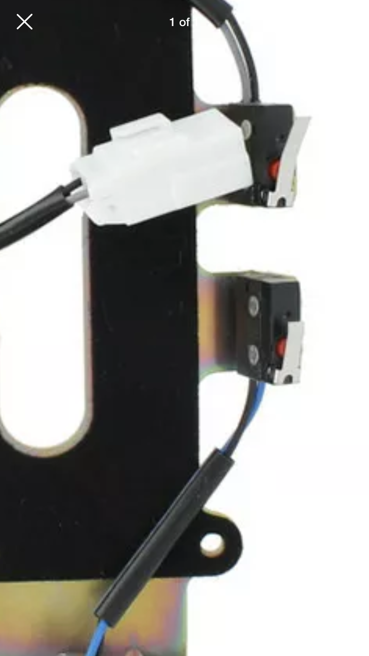

Anyone just replaced the micro switch for the neutral safety switch or the “not in park” micro switch? My 1998 xk8 the tang is broken off the nss.
Replacement plate with two micro switches MJA4940AG.
Big bucks to buy the replacement plate that comes with the two switches MJA4940 AG.
