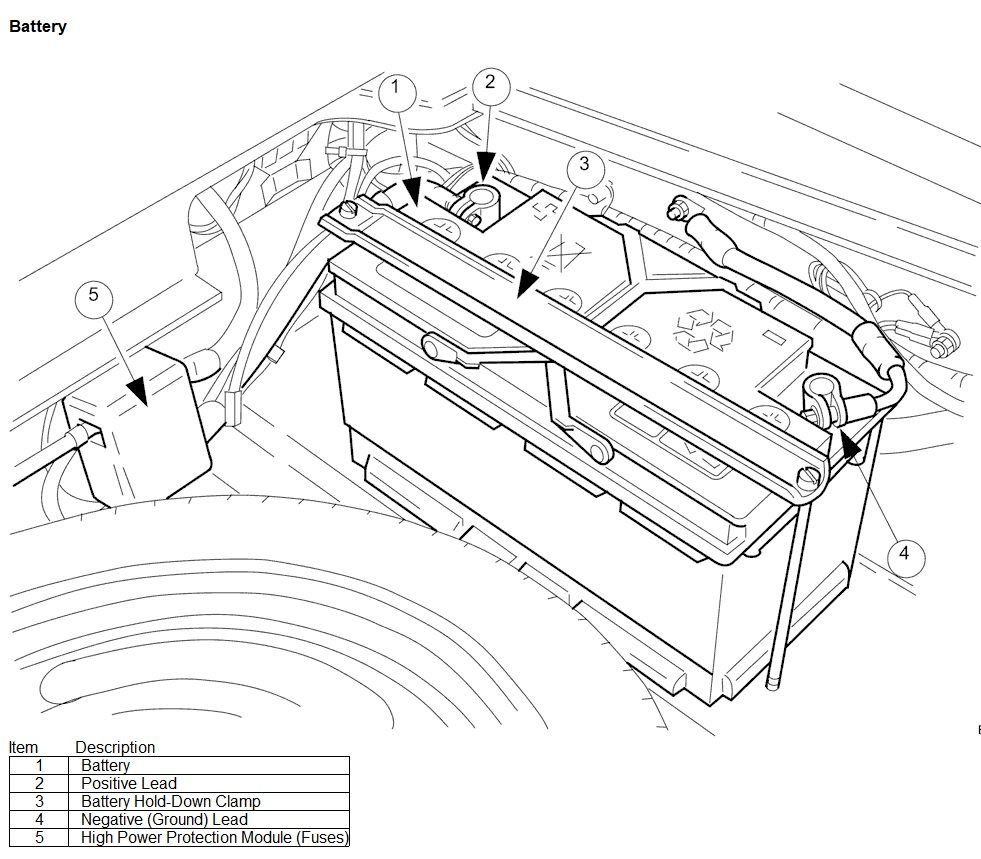

Check the connections in the HPPM (see item 5)
The connections are known to loosen and also for the cable terminals to break up ....... causing intermittent starting difficulties.
Another one for your checklist.
