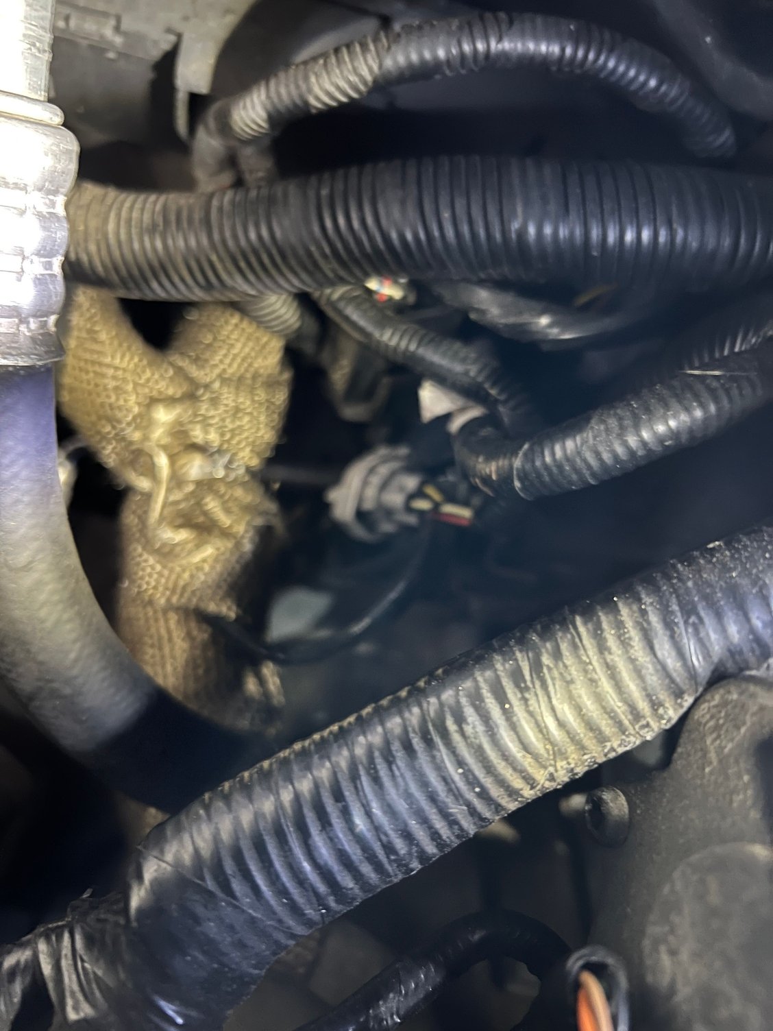

A while ago I had a leaking valley hose and replaced every hose. Never liked how close octopus hose was to the cat. I had some leftover wrap from the exhaust down pipes on my LS swap.

It looks like you lost a heat shield. It's supposed to have a heat shield at the cat-downpipe flange that, in theory, should keep heat away from the octopus hose. Your car does not have it. It seems that rather frequently, the heat shields are either binned by mechanics or they disintegrate with age.

That makes sense. I remember replacing an O2 sensor on a past XJ8 and having to remove the shield. Getting back on was a huge pain. On the XK8 no heat shield either side. On my XJR just driver’s side (US).

Looked through all the parts from my swap project and parts car. Two full sets of shields.

@giandanielxk8 thanks again for the catch. Passenger side easy. For driver had to remove coolant reservoir. Also disconnecting fuel lines gave room to maneuver the shield in.
