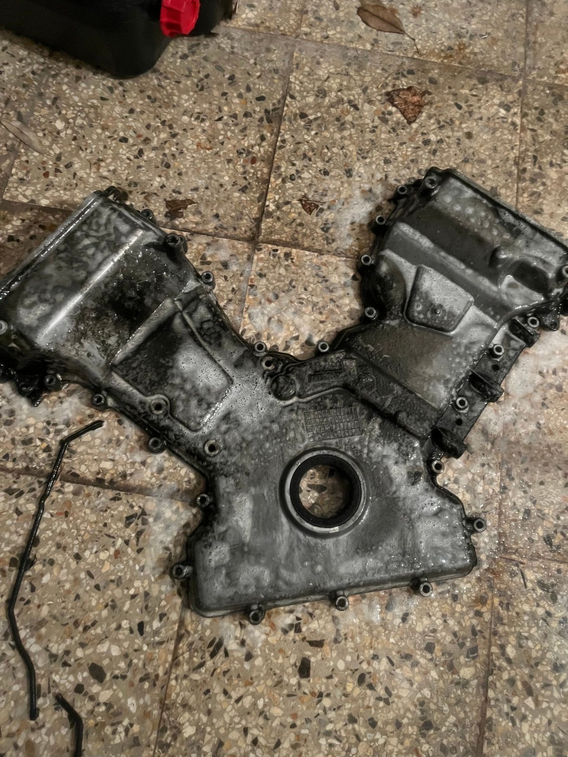

At least one of the engineers, particularly the one tasked with making the timing cover or more likely the one involved in the design of the power steering pump and its bracket.
Why did they make it so the PAS bracket partially covers one of timing cover bolts?! A small relief in the bracket that can fit the 8 mm socket would have made this job much easier but nooooo, they thought it was better to put an obstacle there, but have half of the bolt visible to you, mocking you as it makes you remove the pump and the bracket.
And the PAS pump has its bolts placed at such an angle that it is nearly impossible to have direct access with a spanner or wrench unless you’re sitting on top of the engine for the top bolts. The bottom bolts require that you raise the car and you will have to use a swivel with the spanner. And those 10 mm bolts? Yeah, they will be seized.
Once the pump is out, the bracket is waiting for you with its bolts just as inaccessible. You either have to feel around for them, or use a dentist’s mirror to try to find them. I was able to see one or two when peering through the ABS module pipes with one eye shut and a work light shining from across. There are somewhere between 4 and 5 of them, each harder to see than the last. And they sit almost flush with the bracket which makes it harder to feel for them. At least removing them with a spanner doesn’t require contortionism to find the just right angle at which you can actually apply some torque to them.

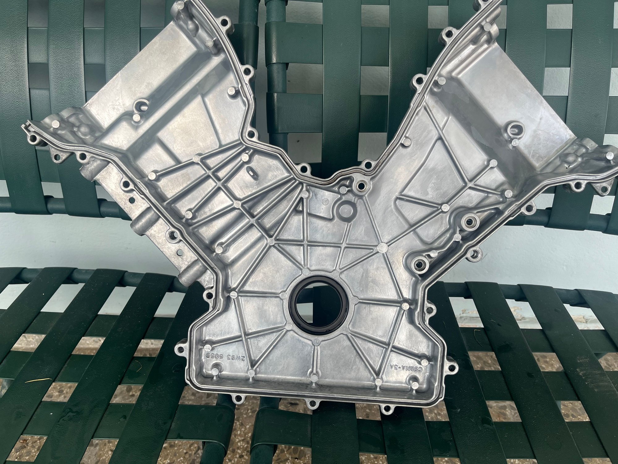

Once it’s out, you get to finally remove the timing cover and realize that you’re only half-way done as there’s a laundry list of things to that you have to re-install once you’ve cleaned all the leaked oil installed the new gaskets.
Good luck.
Seriously, I think this was meant to be an engine out job that can be done on the car but it will cost you your back, and some choice swear words.

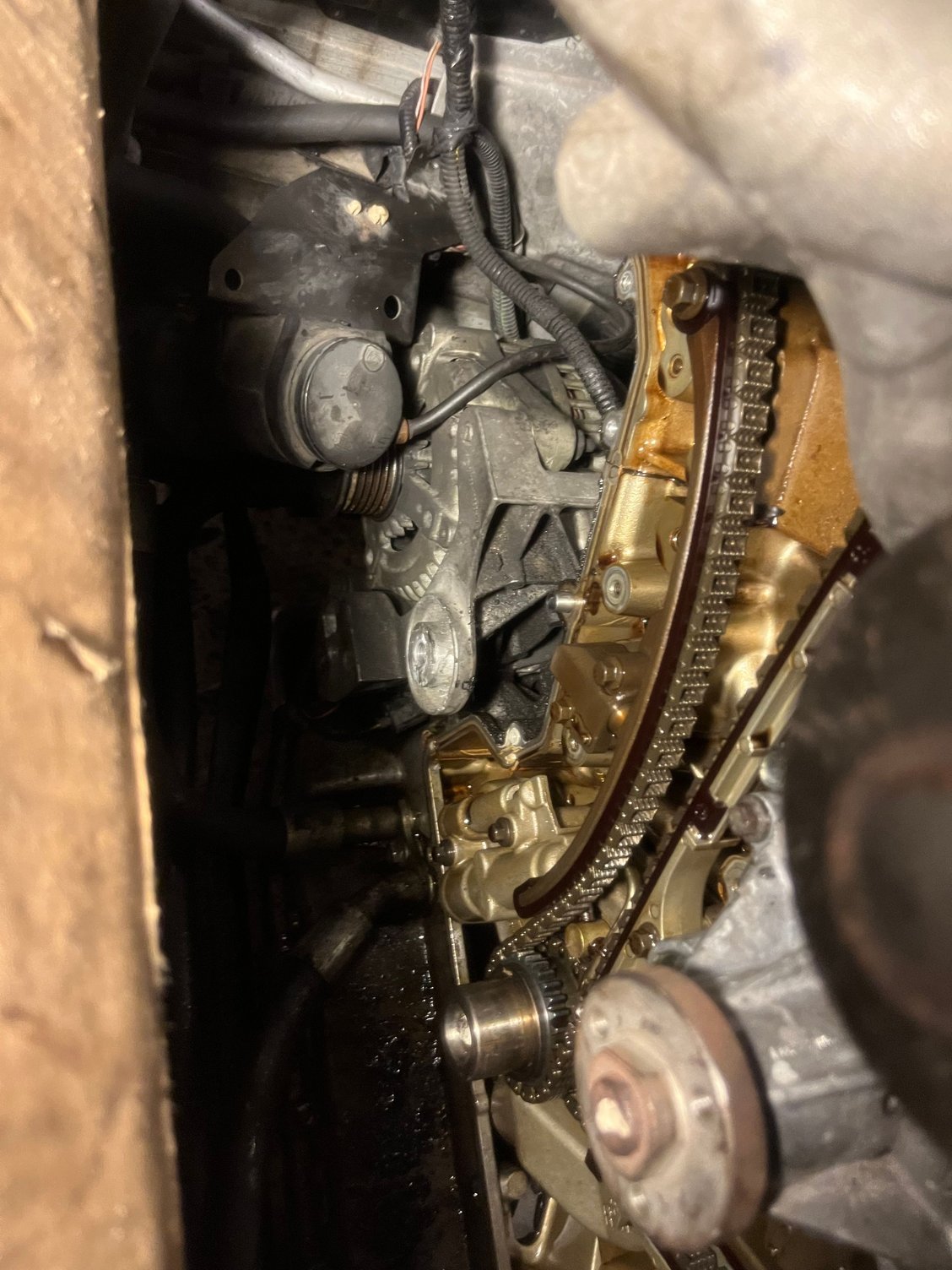

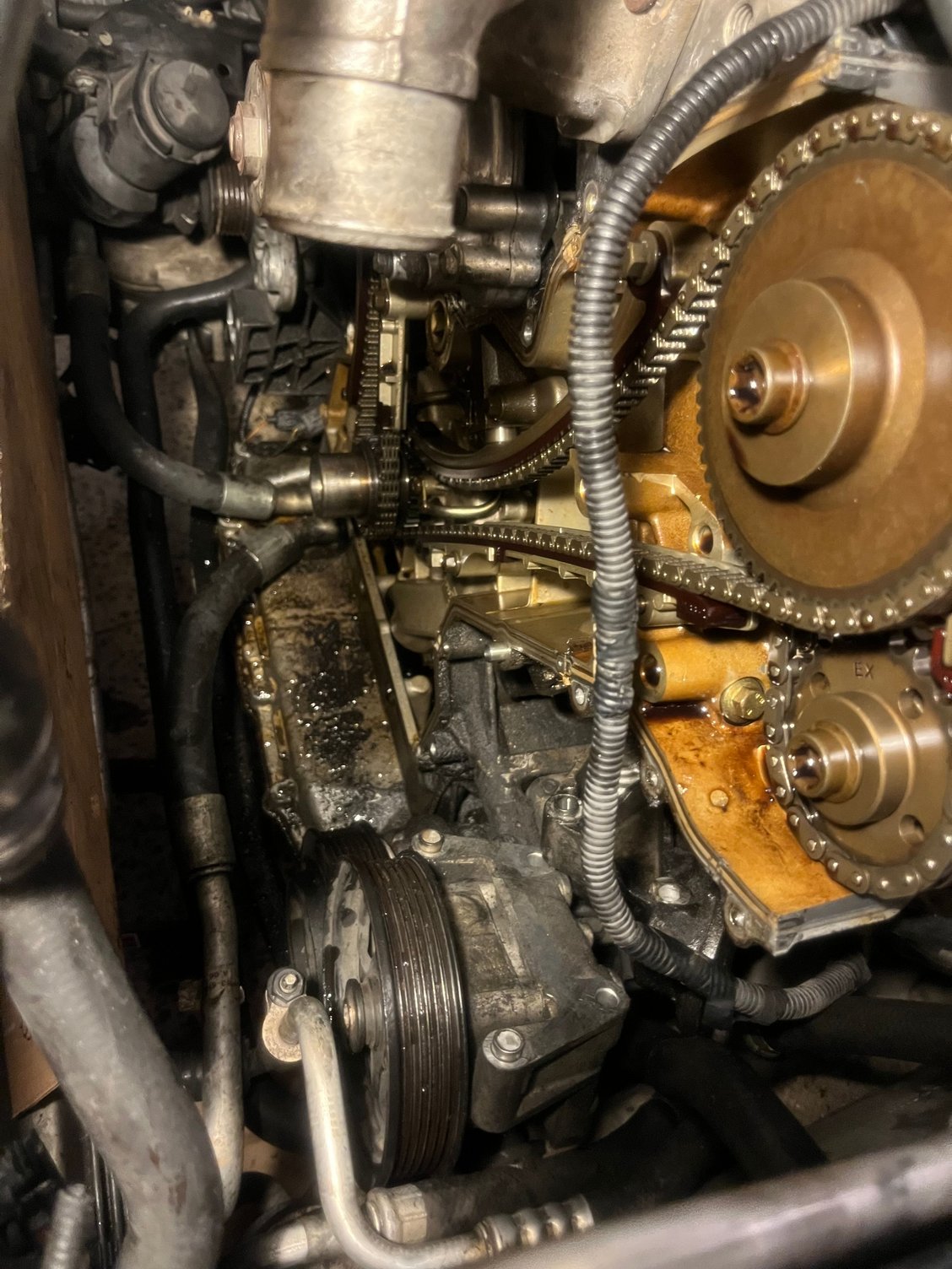

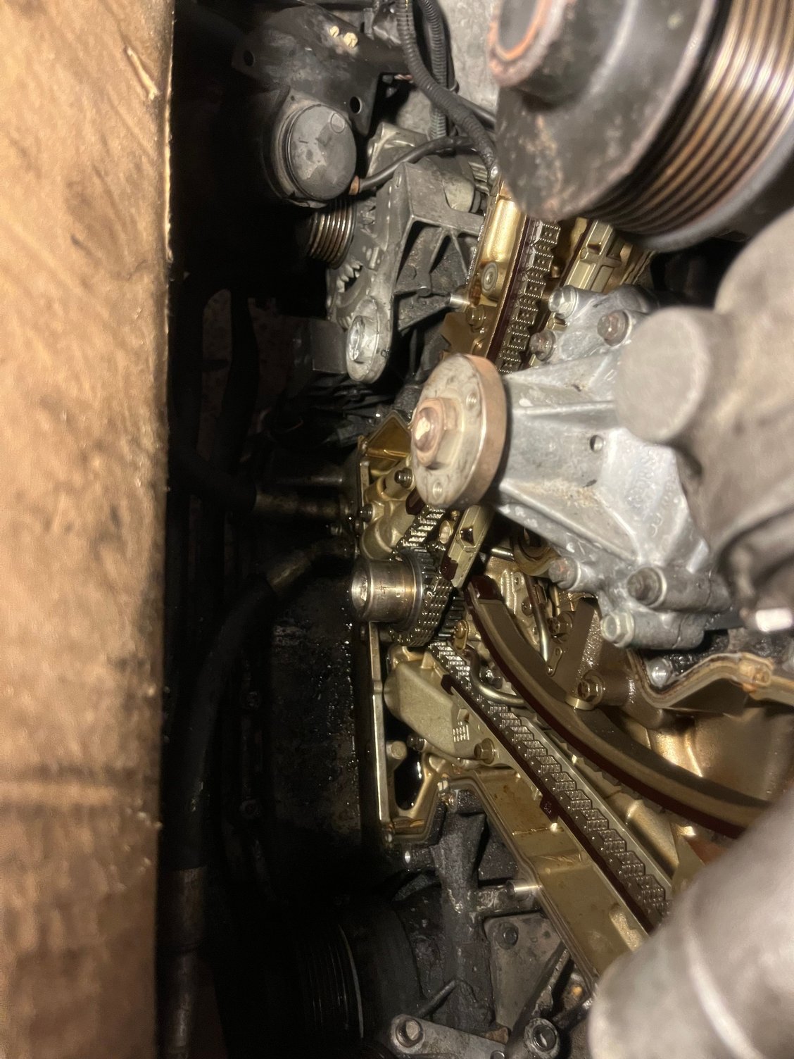

I never want to change the timing cover gaskets again. After all this trouble, I took a look at my chain guides and tensioners. They are in great shape, which is to be expected on a 4.2 that has only done 93k miles.

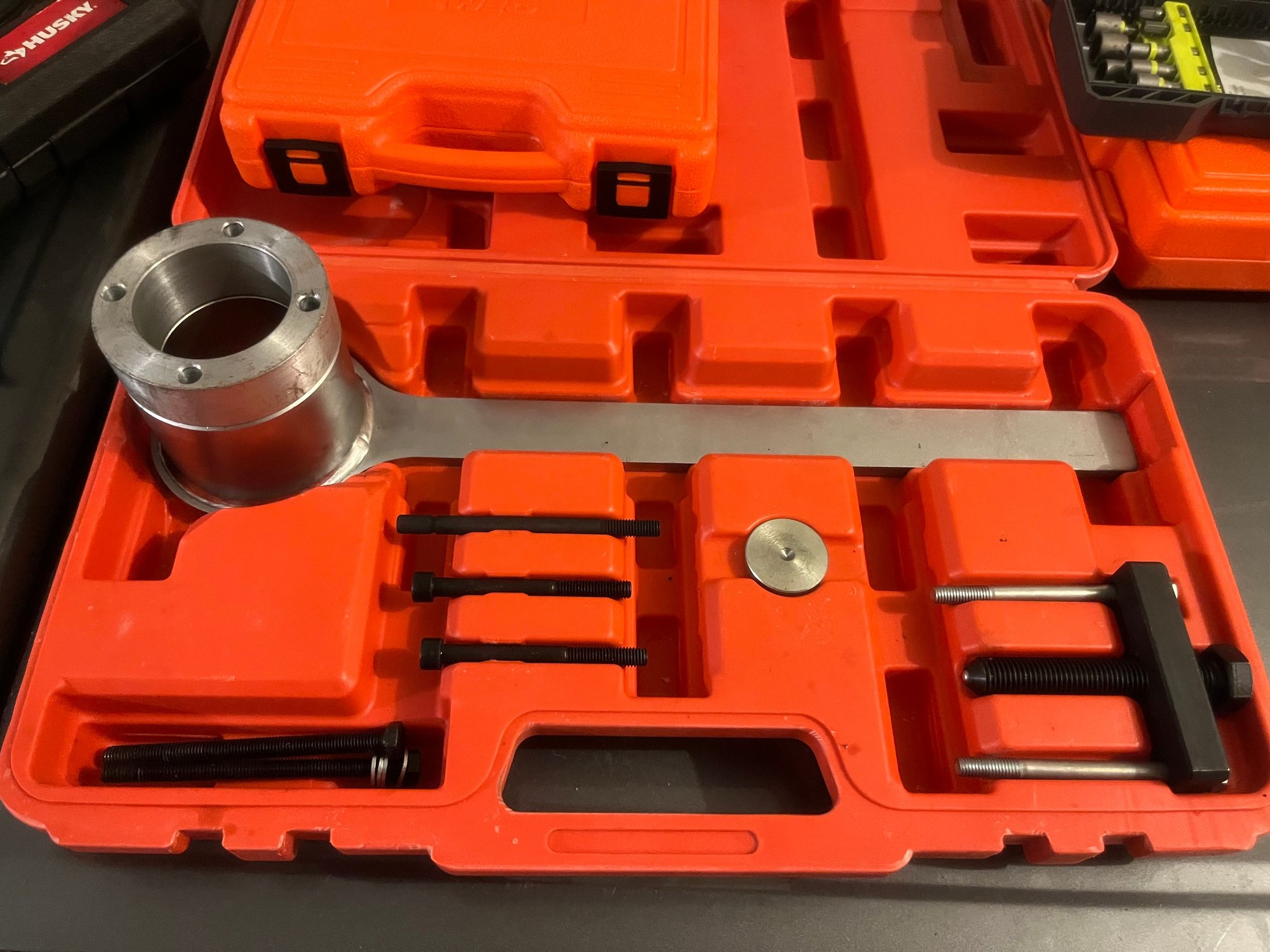

I had bought an ebay tool only to find it was not deep enough for the supercharged V8’s pulley. I had a machinist fabricate an extension and it worked perfectly.
